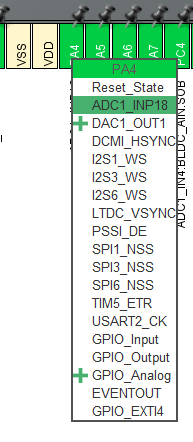

The signal is connected to PA4, evaluated by ADC1CH18, no PU, no PD.

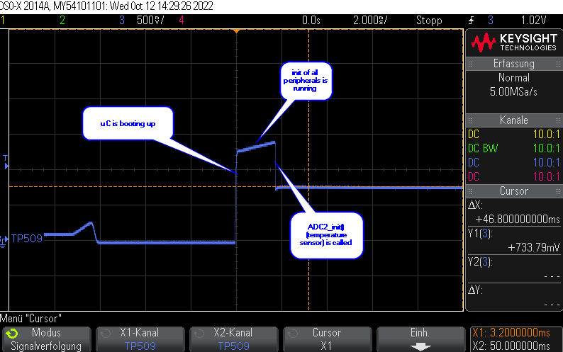

During initialization, everything is fine, the signal has something around 1.78V. As soon as ADC2 is initialized, the PA4 pin will be pulled down to 0.7V. This is not expected behavior, as PA4 is not connected to ADC2 in any way and the input impedance should way higher than ~2k.

Single-step the program, including Cube if you used it. At which point does gets the input pulled down?
Are valid voltages on VDDA/VREF+ pins?
froesel
Hi JW,
debugged step-by-step. The problem occures as soonas the temp channel of ADC2 gets configured:

afterwards, voltage level is 0.7V.

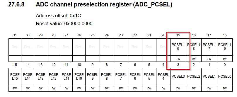

so PCSEL19 of ADC2 is written... seems not ok to me, as this is the Vref_sense of ADC2 (which is actually enabled for adc2, too but is set in some lines before) voltage and not the internal Vsense for temperature sensor signal. Could someone confirm this behavior? 0693W00000Unz1NQAR.png0693W00000Unz1DQAR.png0693W00000UnyzCQAR.png
waclawek.jan

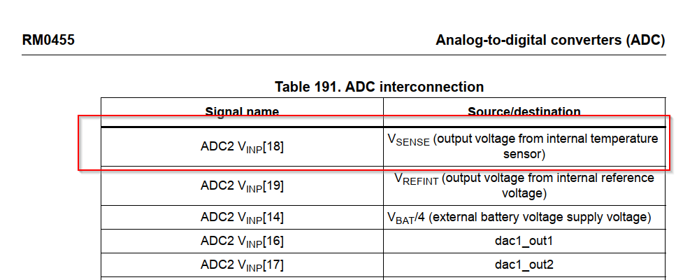

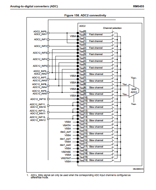

0xc4207 - 0x84207 = 0x40000 and that's bit 18, so that's indeed the temperature sensor, not VREFINT. Bit 19 was already set before line in question (although IMO that shouldn't be a requirement either).
Nonetheless, IMO the temperature sensor should never be connected to the external pin, and marking of PA4 in DS indicates that it should be connected only to ADC1_INP18 not to ADC2_INP18.
@Amel NASRI​ , can you please have a look at this? It appears to be a candidate for an erratum.
Also, if the temperature sensor subchapter is correct, software - thus Cube - should not set ADC2_PCSEL.PCSEL18 bit at all.
