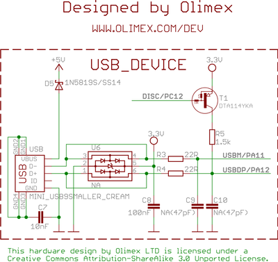

I’m facing an issue with an STM32L4-based design where the USB FS Device stack (CDC) sporadically fails to start correctly. Maybe someone has seen similar behavior or can point me to potential root causes.
System overview / setup
  • MCU: STM32L4 (CubeMX / HAL / FreeRTOS)
  • Clocking:
    • MSI as system clock (16 MHz)
    • USB via PLLSAI1 (48 MHz)
  • USB: FS Device Stack (CDC), initialized after HAL_Init() / SystemClock_Config() in the first Task
  • ESD protection: USBLC6-2SC6
  • Lines: no series resistors on D+ / D-
  • Firmware Package Name and Version: STM32Cube FW_L4 V1.15.0
  • Hardware layout:
  • Clock configuration:
  • USB Stack configuration:

  1. Series resistors on D+ / D-
  2. ESD protection (USBLC6-2SC6)
    • Could this component disturb the USB lines under certain conditions?
  3. Layout / signal integrity
    • Are there known issues if USB differential pairs are not perfectly routed (impedance, symmetry)?
  4. USB stack initialization
    • What exactly does the stack expect at startup?
    • Are certain voltage levels on D+ / D- required to be stable?
Looking for:
  • Experiences whether missing series resistors are really critical.
  • Layout recommendations for USB FS with STM32
  • Known pitfalls with ESD protection and USB initialization

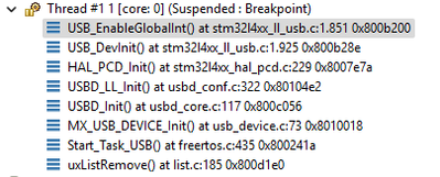

Martin42
thank you for you answer.
I have noticed that the issue occurs when setting the interrupt register in the USB_EnableGlobalInt() function. Specifically, the system hangs at the following line:
USBx->CNTR |= (uint16_t)winterruptmask;
 In the function:
HAL_StatusTypeDef USB_EnableGlobalInt(USB_TypeDef *USBx)
  uint32_t winterruptmask;
  /* Set winterruptmask variable */
  winterruptmask = USB_CNTR_CTRM  | USB_CNTR_WKUPM |
                   USB_CNTR_SUSPM | USB_CNTR_ERRM |
                   USB_CNTR_SOFM | USB_CNTR_ESOFM |
                   USB_CNTR_RESETM | USB_CNTR_L1REQM;
  /* Set interrupt mask */
  return HAL_OK;
Below is the call sequence for this issue:
Has anyone experienced a similar issue or has any idea why setting the interrupt mask could cause the system to hang? Are there any known problems with accessing the CNTR register or timing issues during USB stack initialization?

Martin42
I performed a test where I removed the USB protection circuitry and connected D+ and D– directly to the USB-C connector. Interestingly, the firmware still occasionally hangs during startup in this configuration.
However, when I plug a USB-C cable into the connector, the firmware starts reliably without any issues.
Question:
What could be causing this behavior?
Is it possible that the presence of the cable influences the line termination or voltage levels in a way that stabilizes the USB stack initialization? Could this be related to pull-up/pull-down behavior, impedance matching, or floating lines when no cable is present?
Any insights or similar experiences would be greatly appreciated.
