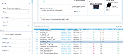

I chose the Nx_SNTP_Client example through MX and created a STM32CubeIDE project. The board I'm using is STM32H747I-DISCO.
When I run it on the board, I only get the message "The network cable is connected." and I can't get a DHCP IP. When I try to debug, Tx doesn't run even once.

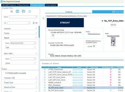

I also checked if DHCP works on the NUCLEO-H723ZG board. The Ethernet-related examples supported by MX on the NUCLEO-H723ZG board include TCP echo client and TCP echo server, and both examples use DHCP. In these examples, only the message "The network cable is connected." is displayed, and the assigned IP is not displayed. When measuring the TX signal through the scope, no signal is output.
Please help.

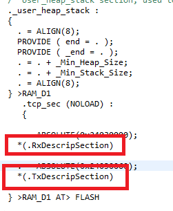

I found the cause of the problem.
There was a typo in the Ethernet DMA section of the project created by CubeMX.
You can fix the following in the STM32H747XIHX_FLASH.ld file.
RxDecripSection ==> RxDescripSection
TxDecripSection ==>TxDescripSection
