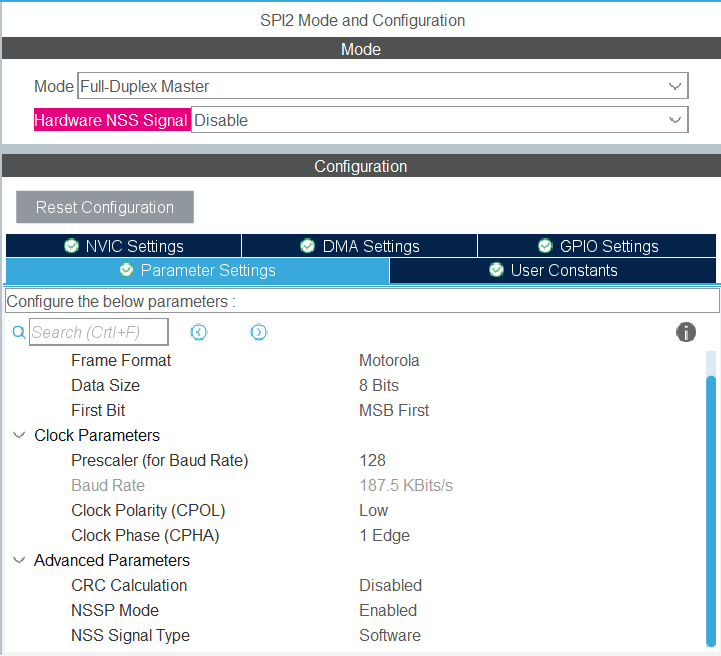

My SPI settings:
I'm using SPI for writing and reading to the SD card.
0693W00000D0tFIQAZ.pngThis is my FATFS configuration
