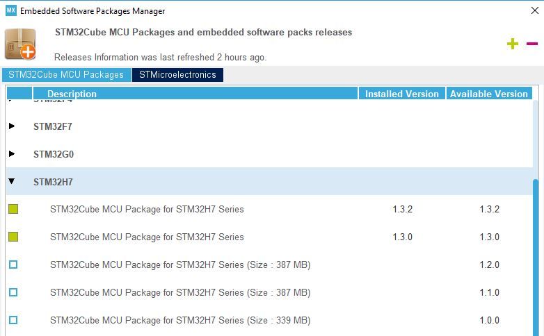

Hello @ranran ,
You can download the previous version of STM32CubeH7 through STM32CubeMX tool, selecting Help > Manage embedded software packages.
