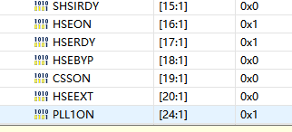

When init dsi the func ran into Error_Handler,bucause of HAL_TIMEOUT
99
- MCU : STM32U5F9VJT
- HAL 驱动程序版本号:V1.6.0
当 init dsi de flag DSI_FLAG_PLLLS始终为 0.检查 enable 寄存器时,标志是可以的。

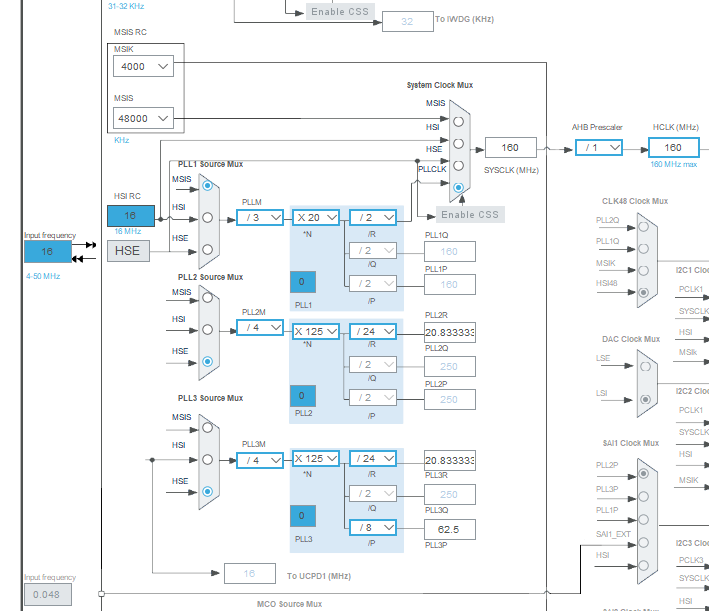

  PeriphClkInit.PeriphClockSelection = RCC_PERIPHCLK_DSI;
    PeriphClkInit.DsiClockSelection = RCC_DSICLKSOURCE_PLL3;
    PeriphClkInit.PLL3.PLL3Source = RCC_PLLSOURCE_HSE;
    PeriphClkInit.PLL3.PLL3M = 4;
    PeriphClkInit.PLL3.PLL3N = 125;
    PeriphClkInit.PLL3.PLL3P = 8;
    PeriphClkInit.PLL3.PLL3Q = 2;
    PeriphClkInit.PLL3.PLL3R = 24;
    PeriphClkInit.PLL3.PLL3RGE = RCC_PLLVCIRANGE_0;
    PeriphClkInit.PLL3.PLL3FRACN = 0;
    PeriphClkInit.PLL3.PLL3ClockOut = RCC_PLL3_DIVP;
    if (HAL_RCCEx_PeriphCLKConfig(&PeriphClkInit) != HAL_OK)
      Error_Handler();

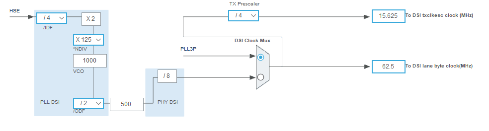

//the clock of dsi
  hdsi.Instance = DSI;
  hdsi.Init.AutomaticClockLaneControl = DSI_AUTO_CLK_LANE_CTRL_DISABLE;
  hdsi.Init.TXEscapeCkdiv = 4;
  hdsi.Init.NumberOfLanes = DSI_TWO_DATA_LANES;
  hdsi.Init.PHYFrequencyRange = DSI_DPHY_FRANGE_450MHZ_510MHZ;
  hdsi.Init.PHYLowPowerOffset = PHY_LP_OFFSSET_0_CLKP;
  PLLInit.PLLNDIV = 125;
  PLLInit.PLLIDF = DSI_PLL_IN_DIV4;
  PLLInit.PLLODF = DSI_PLL_OUT_DIV2;
  PLLInit.PLLVCORange = DSI_DPHY_VCO_FRANGE_800MHZ_1GHZ;
  PLLInit.PLLChargePump = DSI_PLL_CHARGE_PUMP_2000HZ_4400HZ;
  PLLInit.PLLTuning = DSI_PLL_LOOP_FILTER_2000HZ_4400HZ;
  if (HAL_DSI_Init(&hdsi, &PLLInit) != HAL_OK)
    Error_Handler();

99
it does not work .
i check the colock is same with DSI example.21.png屏幕截图 2024-09-24 084815.png
