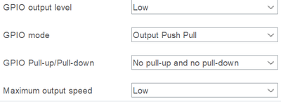

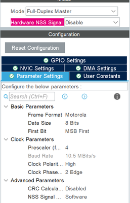

Is your spi CS is done automatic or manual? Make sure to enable the chipSelect for the device. Check the sPI speed,  data width etc. you can try with HAL calls to ensure that the chip is responding, before going into the LL calls. This is just a suggestion to rule out any hardware issues. Another point is that after you apply reset to the chip, you need to wait for some time till the chip is ready to take any commands..
Thank you for your response, @Techn
spi CS is done manually.
Is it possible to tell us how to enable chip select for the device?
best regards.
Did you keep your SPI_polarity  HIGH, SPI phase is 2nd edge. Then configure the GPIO connected to the CS pin of the device to GPIO output and make it low while reading . Please share the ioc file
I think the setup is done.
Thank you in advance for your cooperation.
select GPIO output level as high since the default for CS is high, the chip is not selected normally, selected only when you do the read
