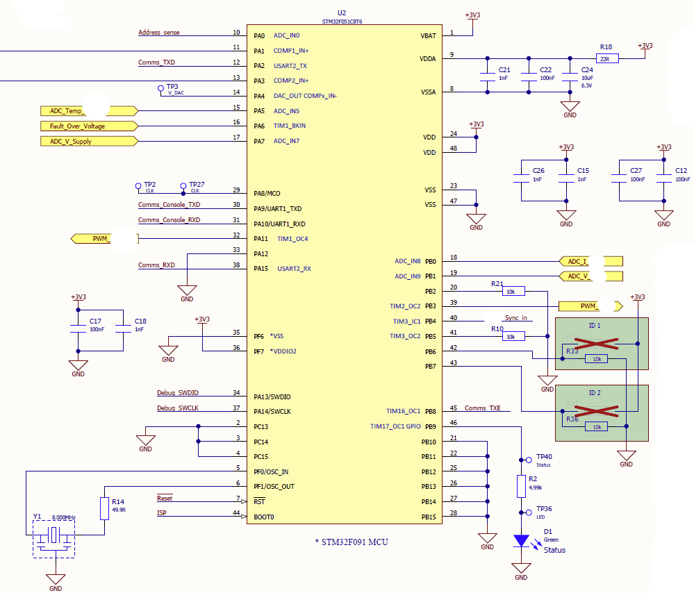

We have two boards that have been created.  Both are designed to use the STM32F091CC for development, and then also the 030 and 051 for release.
This problem only seems to exist on board &sharp1.  Board &sharp2 uses the identical processor, and uses a very similar electronics design but are different designs and PCBs.  This is from board &sharp1.

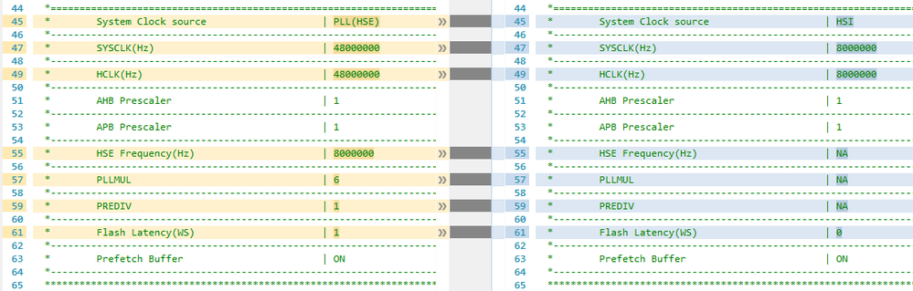

The external resonator has been replaced a couple of times, and the HSI has also been used.  The system init call was generated using the excel spreadsheet ''STM32F0xx_Clock_Configuration_V1.0.1''

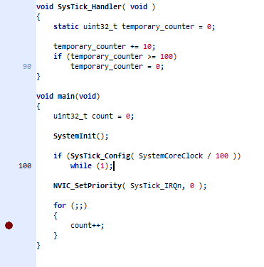

Since i can't work out how to paste formatted source code, I need to include a screenshot...  which is a bit of a pain.  This is about the simplest example I've boiled it down to that demonstrates the problem.

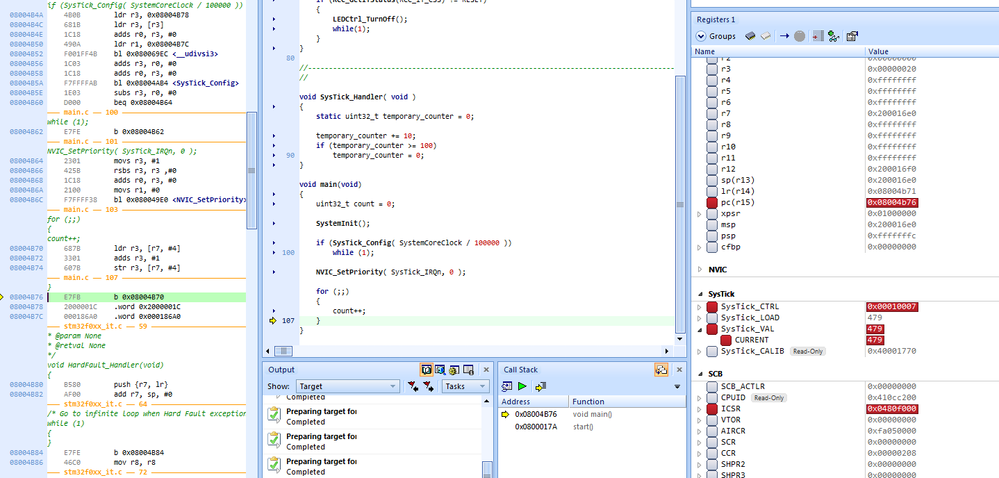

Now, specifically, the problem seems to be that when the SysTick interrupt occurs (although I suspect any interrupt will cause this).  Here's a snapshot of the system state just as the SysTick counter reloads and sets its' interrupt flag - On Board &sharp1

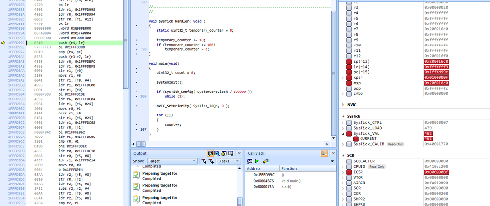

One more step takes us way the hell out in to no-mans-land...

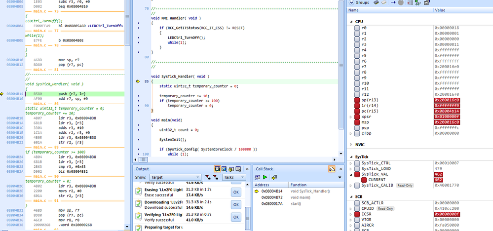

Running the exact same code on Board &sharp2, the action of just one more step takes us exactly where we expect to end up
What the hell is going on here...?!

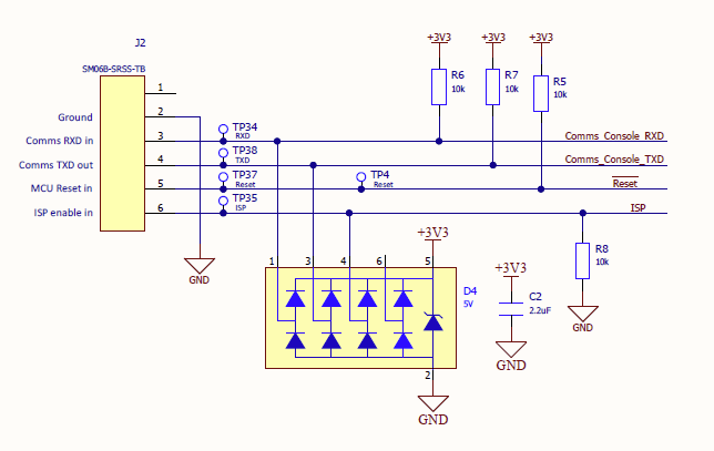

It turns out R8 was missing (context shortly).  How did we work this out?  Well, as I was writing this I started to wonder why this weird area of memory looked a little too structured...  Oh wait, that's system memory.  That's just weird...  Why are we in system memory after an interrupt?  Okay, so that's the bootloader...  wait, what?  That's just weird...  Oh well, i'll just check the Boot pins.  Yep, looks fine...  i'll just have a look at the PCB as well.  Hey, why the hell is R8 not on the board.  It's not marked as DNF...  It is on the BOM, but it wasn't in the part designator list that had been entered in to Digikey against each part.  The other 25 something 10K resistors were listed properly on the received packaging from DK, but R8 wasn't there...  and so the numpty technician didn't fit it when building the prototypes.  Which I think was fair enough, in a way...  since it was me.  Dammit.
But, the reason for continuing this post is to help some other poor sod (kiwi/aussie slang for ''poor bastard'') who ends up in a similar situation.  The question now being...
Why does the processor jump to System Memory when hitting the SysTick interrupt event?  And why does the processor do that even after booting and has already inspected the state of the boot0 pin?

Dump the memory at ZERO, if it maps to the ROM, and SCB->VTOR is set to zero then interrupts will go off there, and the addresses point into the native address of the ROM
The CM0 doesn't provide for a SCB->VTOR, but does have a mapping register to get FLASH, ROM or RAM shadowed at zero post boot. The CM0+ does have a SCB->VTOR.
The debugger that knows your Reset_Handler might well hide the startup issue.
We get BOOT0 issues here quite frequently. There was one just the other day where a clean power up booted from FLASH, and warm reset booted to ROM. BOOT0 floated, but apparently didn't reach VIH in the power up case.
