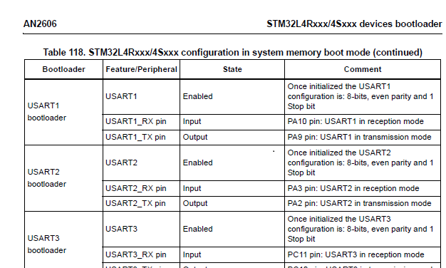

AN2606 lists all peripheral units that are always re-initialized (e.g. UART, SPI, I2C, ..)
What happens to the other ports and GPIOs (e.g. Port E/F/G)? Are all GPIOs reset or do they keep their last status?
I want to update from another chip via USART3, but the voltage supply of the chip is at port G. It is necessary that a pin is in a high state. If I jump into the bootloader, the pin is in reset state and the voltage is switched off.
I have already tried to jump into the bootloader with the option bytes and with a direct jump to the memory address. It also works on another board, but the power supply does not depend on a GPIO there either
Is there an application note that describes what the default bootloader does with unused GPIOs? Or do I have no chance and have to write my own boot loader that necessary GPIOs remain in their state?

It only enables clocks and peripherals it is using, if it uses PC11 I suspect it enables the clocks and blind writes into registers it assumes are at reset defaults.
If you use HAL_NVIC_SystemReset() that's obviously going to reset all the HW registers/settings.
If the system loader doesn't work as you want your options are to use your own loader, or perhaps patch the system loader, or select secondary entry points.

You can disassemble or single-step the bootloader to see what does it exactly do.
I personally wouldn't rely on that, though; ST may decide to change the bootloader in the future. In other words, if the behaviour of the default bootloader does not suit your purposes, you ought to write your own.
This said, I do agree that this is a kind of information which should be documented. However, note, that this is a primarily user-driven forum with only casual ST presence; you might want to contact ST directly, through web support form or through FAE.

@Uwe Bonnes​ JumpToBootloader() does, mostly, just jump to the bootloader. Stepping through the assembly with the debugger: the jump to the bootloader (0x1fff0000 IIRC) occurs with my GPIO untouched. But soon inside the bootloader, the bootloader nukes GPIO. I even tried setting the LCKR (gpio lock) bits, but the bootloader gets around it and nukes GPIO anyway.
Bottom line: I CANNOT find a way to prevent bootloader from messing with GPIO, including GPIO not used by the bootloader.
