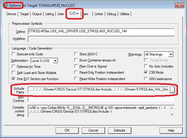

Hi everyone,
I tried to copy the folder STM32Cube/cubeF4... so when i change something it doesn’t make any changes in the original folder, so then I compiled , the error was in main.c (#include “main.h�?) (no such file or directory).
thanks
Should be under the project options tabs for whatever tools you are using, perhaps review docs related to "Include Paths", it is a standard C compiler concept.
7 REPLIES 7
So either you haven't copied all files the project consists of, or you don't have your Include Paths set up correctly.
Paths can be relative in certain tools, so a directory copy needs to maintain the same depth.
For Keil you can simple duplicate/clone a would directory, and sub-directories, at the same level

I can’t understand what you meant..
Which part?
The part about copying complete directories properly, and at the same level/depth?
Or the part about configuring your tools so they can search the appropriate file paths to find the files making up the project?
The part about configuring the tools so they can search the appropriate file paths to find the files making up the project..
Clive Two.Zero thank you very much, I learn faster and more efficiently than at school, I thank you very much :hugging_face:
