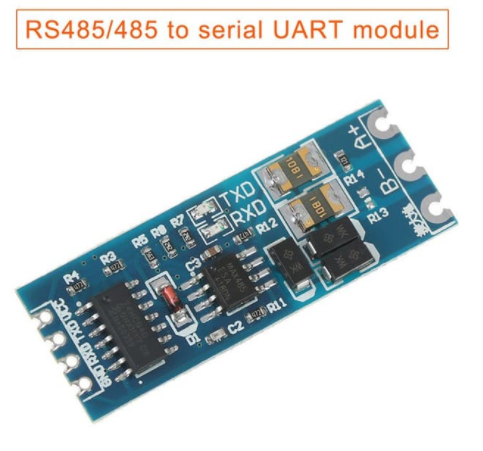

Fahmi Maulana
i have an idea for this, you can use module uart to ttl (max485 with inverter 74hc14), only need 2 pin (Rx Tx), so u can programming over there. entry into serial bootloader and flash it, hope it working properly0693W000003Qry8QAC.png
