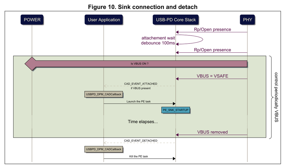

Dear @Peterson​
In USBPD_CAD_STATE_ATTACHED_WAIT state, CAD module is waiting for a stable VBUS voltage higher than USBPD_PWR_HIGH_VBUS_THRESHOLD (2800mV).
Could you please at first check you measure correctly the VBUS voltage in the function 'BSP_USBPD_PWR_VBUSGetVoltage'?
You may display the VBUS voltage into your log in using the tip described in ST Wiki page.

‎2021-01-04 12:46 PM
Hello Yohann,
The VBUS voltage didn't get higher than 0,5V. After some investigating, I found out a capacitor shorted the VBUS to ground. Now the issue is solved, I can indeed get a 5V contract.
I thought the VBus voltage was enabled when the state changed to ATTACHED. But you are right, debounce and waiting for VBUS is done in the same state. Thank you for your answer!
