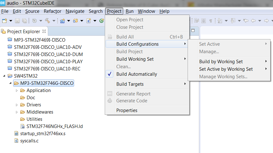

‎2021-01-08 5:49 AM
Thanks for this nice explanation. I have tried what You wrote. Problem was probably also with very long path. After shortening I was able to find this Eclipse project.
Despite this fact, I am still struggling to build, now I have no configuration to choose, do I need to set it manually?
‎2021-01-08 1:43 PM
@Antek​ Try to remove imported materiel and redo promoting full path (....../SW4STM32/MP3-STM32F746G-DISCO) ... sounds to me you've not initiated import from proper level. Obviously you should have build configuration set for you if import done properly.

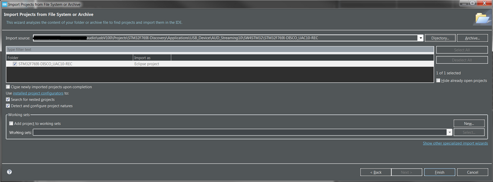

Did anyone try to do that with audio libraries and newest CubeIDE? I am still struggling.
‎2021-01-11 1:56 AM
I am not sure what I was doing wrong but something is starting to work.
Still I warn everyone that paths are really long with these libraries.
I attach screen with correct import.
