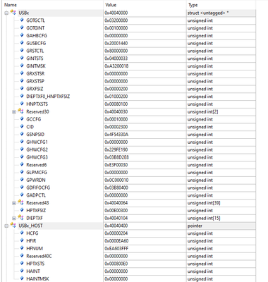

3. I am checking the value of register section 62.14.20, but I am not quite sure the correct value (bit value) in each register. Can you let me know the value or bit value I need to check. The register values in my application are shown below.

Hi @Huiqi
I guess you didn't get my first point.
You mentioned "the D+ and D- signal is connected to ground with 1.5 ohm pull-down resistor. "
However, the datasheet says:
No external termination series resistors are required on USB_DP (D+) and USB_DM (D-); the matching impedance is already included.
You should not add more resistors on DP and DM.
Second, USB clock source must be always 48MHz. The output depends on the operating speed FS or HS. Check the reference manual section 62.4.3 OTG_HS core
Finally try to increase USBD_DEBUG_LEVEL. It is simpler to have middleware logs to debug console than checking each register.
Best regards,
FBL
Huiqi
Dear FBL:
Thanks for your reply, and all the advice you provided.
The problem is found. It turned out that the root casue is the definition of the oscillator frequency. The default is 25MHz in firmware, but the osciilator we used is 12MHz. The enum and following operation worked after that value is updated, along with the prescalers.
Actually, I followed your advice, and checked if the 15K ohm pull-down resister is needed. You are right, it has no impact on the operation.
The USB clock is configured as 48MHz, as you said.
