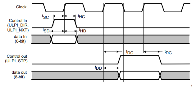

The clock timing requirements written in the ULPI specification are important to ensure that the device can wake up and respond to the host's chirp signal in a timely manner. Additionally, that the clock frequency is stable enough for reliable communication.
Ensure that ts(IN) = 5 ns ≤ (Clock period (tCLK) – tv(OUT)max) is used for proper operation

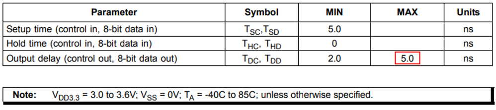

According to datasheet "USB3300 Table 6-2: UPLI interface timing output clock:"
USB3300 Datasheet Table 6-2: ULPI INTERFACE TIMINGUSB3300 Datasheet Table 6-2: ULPI INTERFACE TIMING
  •     Clock setup/hold time(tSC/tSD : tHC/tHD): min. 5 ns / 0 ns
  •     Data/Control output delay(tDC/tDD): (typ.) 2 ~ 5 ns

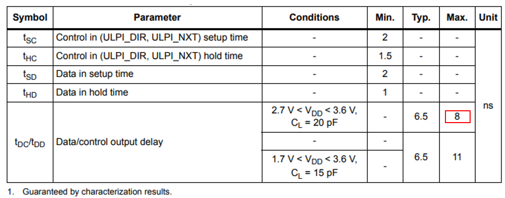

According to datasheet "STM32F77 table 96. Dynamic characteristics: USB ULPI" as an example:
Control in (ULPI_DIR, ULPI_NXT)
  •     Clock setup/hold time(tSC/tSD : tHC/tHD): min. 1 ns / 2 ns
  •     Data/Control output delay(tDC/tDD) @3V3: (typ.) 6.5 ~ (max) 8 ns
tDC/tDD Data/control output delay (assuming @3V3)  8 ns
Clock period (tCLK) – tv(OUT)max = 1/60(MHz) – 8 ns = 8.6 ns
ts(IN), which is tSC, tSD set-up time (control in, 8-bit data in) equal to 5 ns.
  • ts(IN) =5 ns ≤ (clock period (tCLK) – tv(OUT)max=8.6 ns
Around 8.6 ns setup time for this PHY is sufficient.
Caution: @1V8 5.6 ns is risky, so you should look for a different ULPI PHY to meet the requirements.

The ULPI specification provides specific requirements for the timing of all control and data signals that are used in the ULPI interface. This includes requirements for signal setup time, hold time, and output delay, to guarantee accurate reception by the receiving chip.
