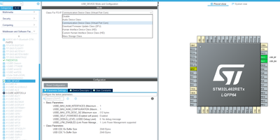

Hi, I would like to enable RNDIS + VCP on this MCU. Is there an option to do that?
I do not know how to enable only RNDIS for this MCU too (I do not see this on drop down with Class for FS IP).
