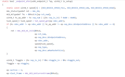

Hi All,
I am working on the STM32U575 for host mass storage class.
I am not using stm32 middle ware for this due to some reasons.
I am using TinyUSB open-source stack to implement the Host mass storage class.
with my current implementation I am able to use HID device, but I got stuck at MSC enumeration.
Currently facing below issue.
1. During enumeration process After sending the Unit Test Ready Command I am getting correct CSW
response from device but soon after that Getting NAK from USB device.
-- What could be the reasons for getting the NAK - Also I after getting NAK I am continuously getting Channel halted interrupt.
I have attached the logic analyzer file for batter understanding.
Any Help will be highly appreciated!
‎2023-12-13 3:14 AM
Sorry my bad, you have to change in _endpoint_xfer() function only,
if (ep->ep_type != 2)
I kept one more check in HAL_HCD_HC_NotifyURBChange_Callback(), but it was for some other purpose.
regarding handling of data more then 256 bytes(rather size more then wMaxPacketSize), you will face that problem may be after making this change. because that is not handled currently in that driver file.
‎2023-12-13 4:18 AM
Great thanks for that, I will change that in _endpoint_xfer()...
‎2023-12-13 11:59 AM - edited ‎2023-12-13 12:01 PM
Hi @RRajb.2
That _endpoint_xfer() change brings it all to life, thanks very much.
If I have the USB inited as HS then both FS and HS devices work fine, I do not get the issue with the transfers being bigger than the packet size.
With it inited as FS then I see the issue that you mention with HS devices, but strangely FS devices work even though the transfers are bigger than the packet size.
Very strange!
Once again thanks for all your help on this, it is really appreciated.
Andy

Well I now have it all working with the HAL so I guess that is not true.
The trick is to use the HAL in the standard way to read full length from IN endpoints but to split the transfers for the OUT endpoints into packets. Obviously it would be better if they would fix this in the HAL but there is a workaround.
