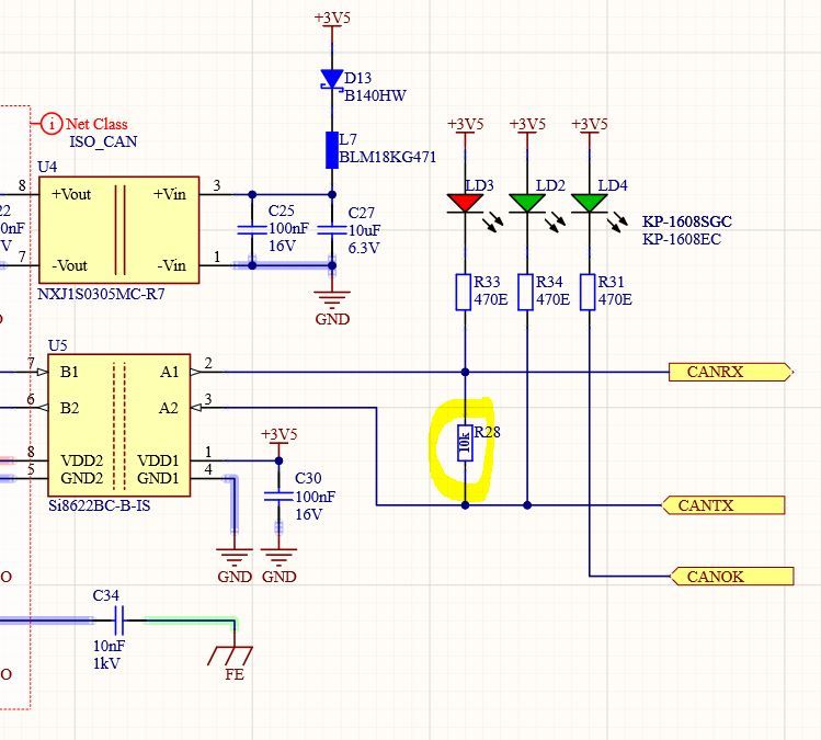

Hello, I am using a STM32G473RC microcontroller and want to use usart3 to update the firmware.
I also use the CAN-BUS on pin PA11 and PA12. These pins (PA11, PA12) are also USB pins (DP and DM).
When I start the bootloader (BOOT = 1 + RESET), the "USB Cable detection" triggers and prevent communication with the USART3.
How to disable the USB cable detection?

Whether the USB cable detection triggers depends on the isolator used.
With an Is8622BC it works fine, with ADUM1281ARZ it doesn't work.
It sounds ridiculous but with a resistor between the CAN1Rx (USB-DM) and CAN1Tx (USB-DP) it works fine with both, Is8622BC and ADUM1281ARZ.
I have reworked 10 PCBs, all working fine.

None of the PCB's communicate through Usart3 in boot mode. I send 0x7F, there is no response.
Until you desolder U5, R33 and R34 (connected to CAN/USB port)
