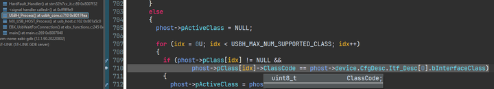

When I use Debugger, I can see a hard fault coming from USBH_Process :
case HOST_CHECK_CLASS:
if (phost->ClassNumber == 0U)
USBH_UsrLog("No Class has been registered.");
else
phost->pActiveClass = NULL;
for (idx = 0U; idx < USBH_MAX_NUM_SUPPORTED_CLASS; idx++)
if (phost->pClass[idx]->ClassCode == phost->device.CfgDesc.Itf_Desc[0].bInterfaceClass)
phost->pActiveClass = phost->pClass[idx];
break;
The phost->pClass[idx]->ClassCode is unknown for SCSI USB 3.2 Keys.
When I use USB 2.0 Key, it's ok ClassCode is known.

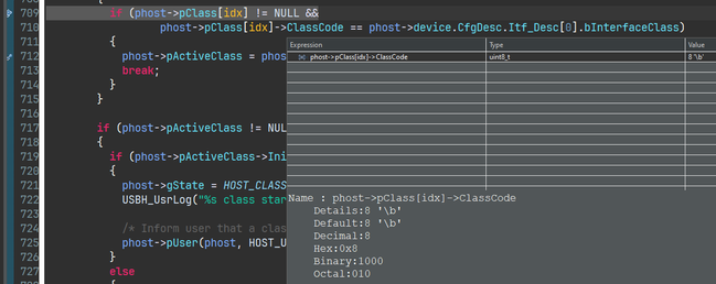

Here are screenshots of what I can see with the debugger.
* When I run the debugger with the MSC USB Flash Drive, USB_Host recognize the key properly:
* When I use the other USB-C Flash Drive with the scsi interface I have a hardfault because pClass[0] is undefined:
