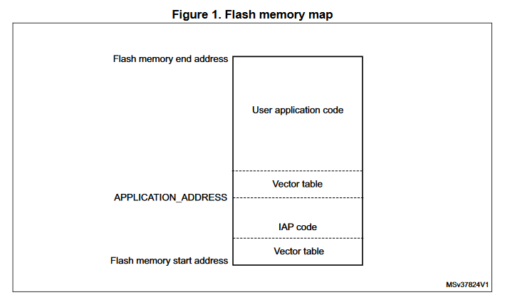

I own a Nucleo-H723 and I would like to know how to update the MCU firmware using the ethernet port to transfer data. I want to send the bin/hex file over TCP (LwIP) and store the file in a external flash (QSPI), as I am not sure that the MCU flash is big enough. Which are the following steps?

>> You can't figure out how to stage the file/content in the memory?
Yes
I have just read AN4657 (STM32 in application programming iap using the usart) and the LwIP IAP example. AN4657 document explains how IAP works but I still do not know how to write the IAP code and the main program. I guess I have to modify the linkerscript but I do not know how to do it.
‎2023-03-31 3:18 AM
Our client needs to update the device using HTTP (DLMS over TCP/IP). The firmware must be updated by connecting a computer to the device or remotely. The LwIP IAP example is very helpful, as it allows to update the firmware using TFTP and HTTP.I think I am going to adapt the example to my project.
