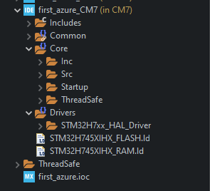

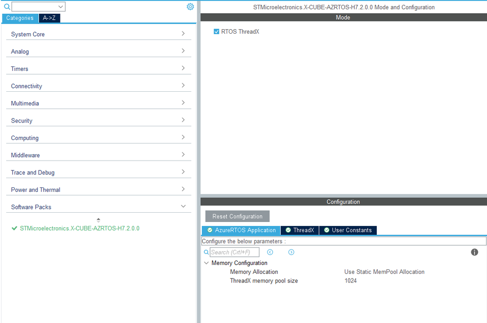

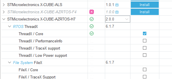

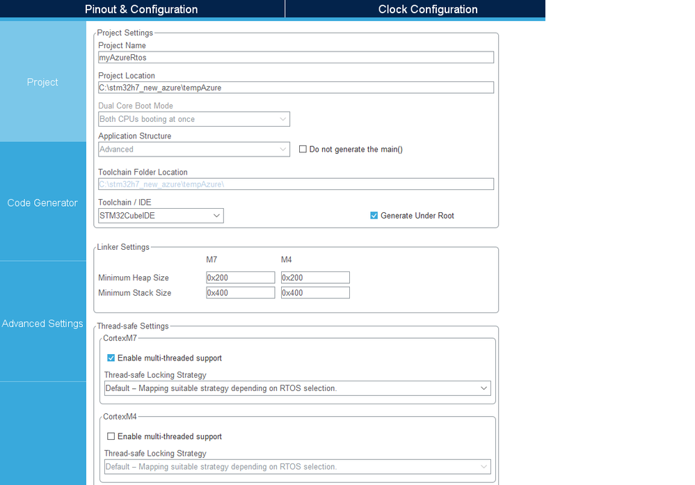

I am trying to create anew project for STM32H745 discovery board.
I included middleware "STMicroelectronix-X-CUBE-AZRTOS-H7 -> ThreadX / Core" option.
But when I generate the code, there is no middleware code in the project.
Please see attached snapshots for more details0693W00000FCe48QAD.png0693W00000FCe6wQAD.png0693W00000FCe6mQAD.png
Hello @Community member​
Probably, you have not configured the ThreadX. Make sure that you configure your ThreadX.
I hope you find this answer helpful. Do not hesitate in case you have other questions.

Hello Walid,
Many thanks for the response. I will give it a go today.
The option did the fix.
