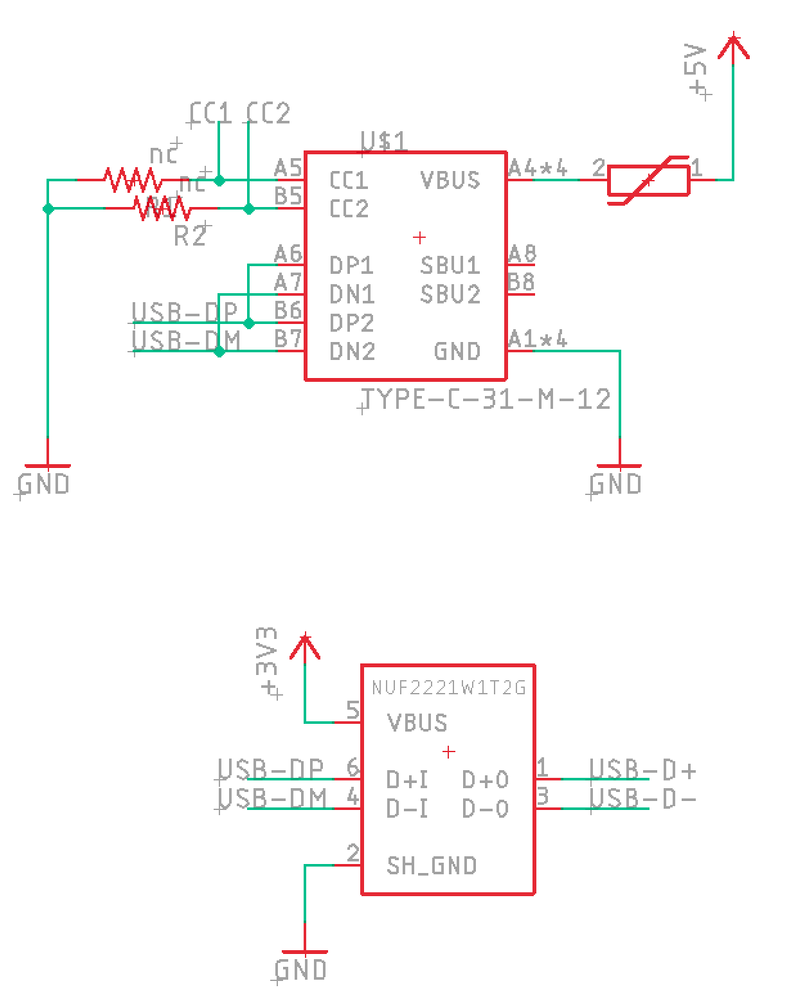

‎2019-11-15 1:34 PM
I'm looking into using the STM32G431CBT6 for a usb device which might need more than 500mA (it's a _really_ bright keyboard).
If possible I'd like to avoid adding a battery to power the MCU up. Also flashing via DFU is a must because nobody has a STLink programmer flying around or knows how to use it.
I've build a breakout PCB around my understanding of the documentation with a USB-C port:
Now when I populate the resistors R1 and R2 in above schematic the breakout board is flashable via DFU. Everything works like I want, however I suspect that populating external Rd resistors will prevent the MCU from negotiating more power (say, 1.5A).
So I'm wondering if I can basically achieve flashing via DFU without populating the two external resistors, using only the internal resistors on the MCU.
And if I have to populate the external resistors, can I still negotiate PD up to a high profile?
I guess being more specific in my original question would have helped here.

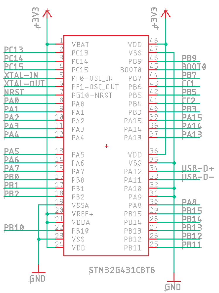

‎2019-11-16 9:35 AM
Have you researched into dead battery mode of USB-C PD? The entire purpose of this functionality is to present the Rd pull-downs so that the source provides that base +5V needed to power your core and PD controller. I think this might be what you're describing.
You do not need to add your own external resistors, as the STM32G431 presents Rd even while the MCU is powered off. It requires 2 additional pins, each one is simply shorted to its respective CC line.
Check this App Note from TI for thorough high-level discussion:
