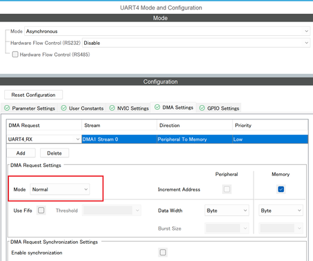

DMA set up in normal mode on UART4 RX.

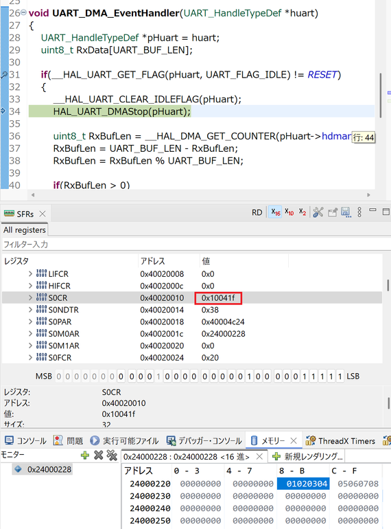

Basically, this works well, but sometimes there is unintended behavior.
Specifically, data is stored after the previously received data, instead of being received from the beginning of the receive buffer.
I checked the register.

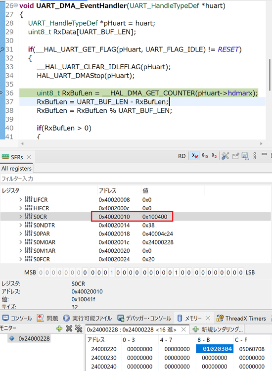

Before stopping DMA, CR register is 0x10041F.
After DMA is stopped, the CR register is set to 0x100400.
It does not change from 0x10041F when an abnormality is occurring.

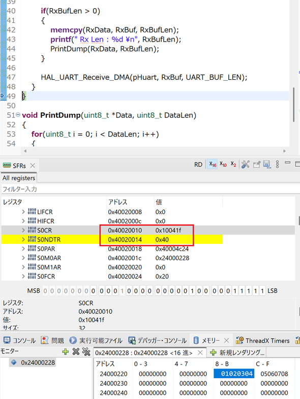

When DMA reception was finally resumed, the CR register was set to 0x10041F and the NDTR register was reset to 0x40.
In case of an error, the NDTR register remains at 0x38, so the reception starts from the continuation of the previous reception.
If the 0-4 bit of the CR register is not cleared when DMA reception is stopped by HAL_UART_DMAStop, should I manually turn off the register?
