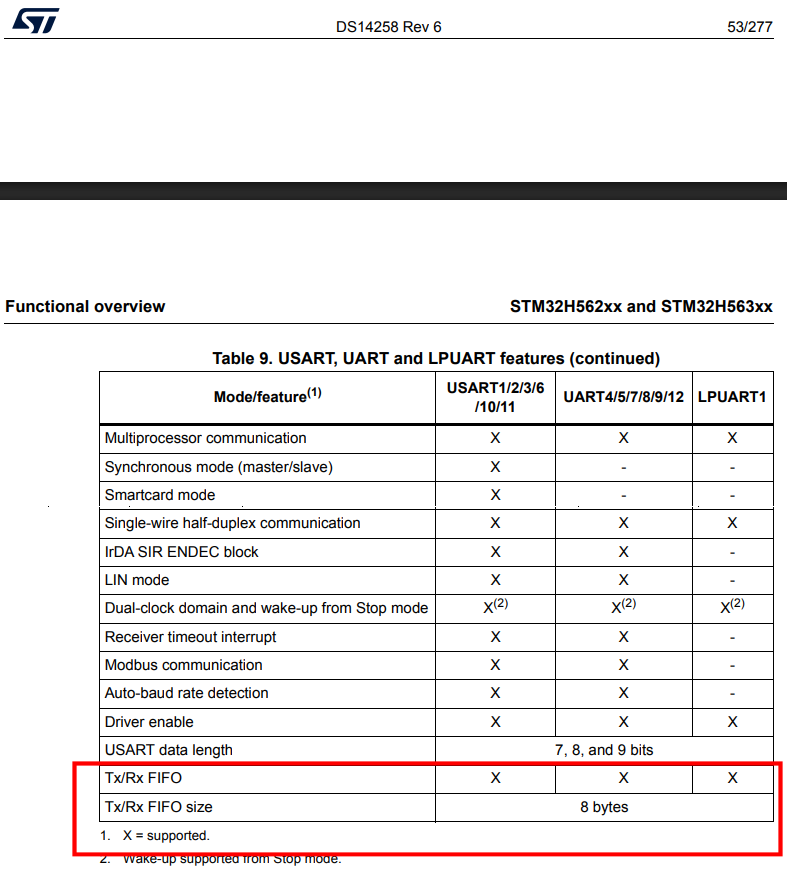

@Andrew Neil wrote:
@NavaneethanN wrote:
3. What are the recommended ... methods for STM32H5 series?
The above is entirely general - Not specific to any particular microcontroller.
One thing the STM32H563 has - which not all other microcontrollers have - is an 8-byte FIFO:
So be sure to make full use of that !
Pavel A.
 What is the best workaround to avoid ORE errors without enabling hardware flow control
As Andrew noted, 115200 is not a high baudrate, if your program cannot reliably handle it with interrupts - then, of course use DMA. With DMA the UART FIFO is not required.
Without DMA, the FIFO alone won't prevent overrun. So:
 - Be always prepared to handle ORE and dismiss it. It can occur even while initializing the UART when you are not ready to handle it yet.
- Use protocols with error detection and retries (Ymodem, etc) to correct any kind of transient errors. Sending raw text is not reliable.
- If you have to receive a lot of raw text, use DMA (correctly! look for examples)  or reduce the baudrate.
Indeed.
But, if used correctly, it should help avoid it happening...
