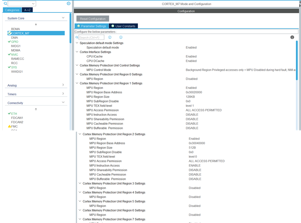

"Let me share my CubeMX configuration with you first so we can review the setup."
1. System Core - CORTEX_M7

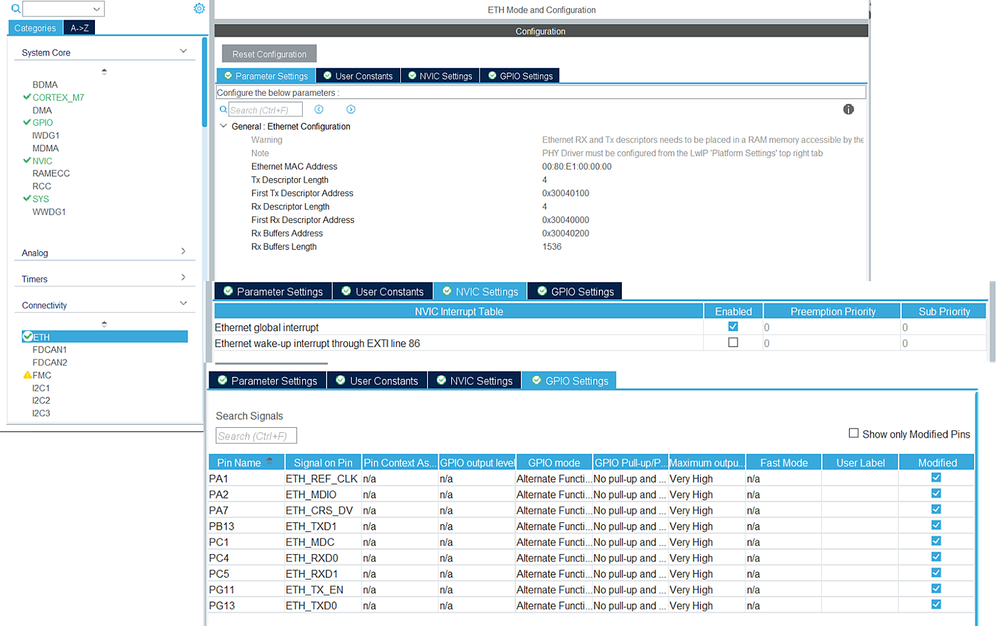

2. Connectivity - ETH

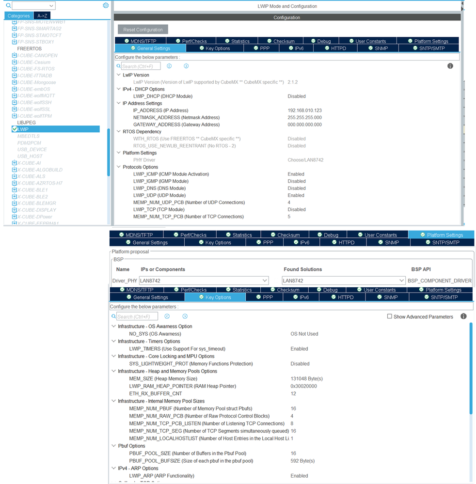

3. LwIP

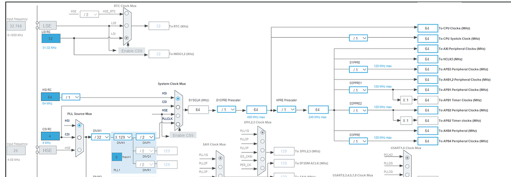

4. Clock

STM32H753ZITX_FLASH.ld
/* Modification start */
.lwip_sec (NOLOAD) :
  . = ABSOLUTE(0x30040000);
  *(.RxDecripSection)
  . = ABSOLUTE(0x30040100);
  *(.TxDecripSection)
  . = ABSOLUTE(0x30040200);
  *(.Rx_PoolSection)
} >RAM_D2
/* Modification end */

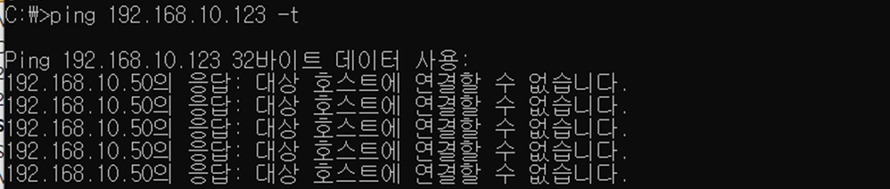

Pinging 192.168.10.123 with 32 bytes of data:
Reply from 192.168.10.50: Destination host unreachable.
I am receiving these messages as shown in the screenshot,
and I'm reached out because I’m not sure what I might be missing in the configuration.
As you can see, I am getting 'Destination host unreachable' errors.
I would appreciate it if you could help me identify what's wrong.

Please assign proper Gateway address.
Also check the Network setting in your laptop. "Lwip_init();" seems to be missing.

  1. MPU Configuration: In the void MPU_Config(void) function, I commented out the following lines:
    • MPU_InitStruct.Number = MPU_REGION_NUMBER0;
    • MPU_InitStruct.Number = MPU_REGION_NUMBER1;

The only misconfiguration I found is that the allocated LwIP heap memory (16KB) is less than the one allocated and protected by the MPU (128KB), and the Rx buffer count is set to 10 instead of 12. Nonetheless, this does not affect the functionality of the project for an application that only handles pings. I suggest you re-download the attached project, apply the modifications I mentioned, and test it.

To answer your question, no, it is not mandatory to use a timer as the timebase source instead of SysTick; it is simply a best practice for RTOS applications. In your case, the application should work using SysTick. I have compared both projects ,the one you attached and mine, and I suggest you enable RCC and set HSE to bypass clock source, as timing is crucial for Ethernet. Please try this and get back to me with your feedback.
