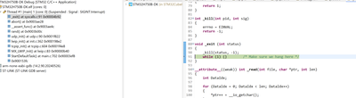

So I figured out that the code get's stuck here.
void tcp_init(void)
#ifdef LWIP_RAND
tcp_port = TCP_ENSURE_LOCAL_PORT_RANGE(LWIP_RAND());
#endif /* LWIP_RAND */
It does not come out of this function and when i pause debugging it goes and hangs as I showed in above picture.
Please let me know if you need anymore details.
Hello @PushparajAdka
Did you enable the D2SRAM1 clock with the instruction below?
__HAL_RCC_D2SRAM1_CLK_ENABLE();
