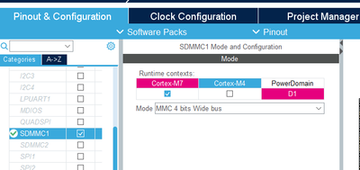

Hi all,
I am using the MTFC8GAMALNA-AAT 8GB flash memory via SDMMC1, operating in MMC 4-bit wide bus mode, along with FATFS (M7). I now require the diskio.c file. Kindly provide it, or if you have any related example code, please share that as well. Please note that I do not want to use DMA or an RTOS for this implementation.
Thanks
