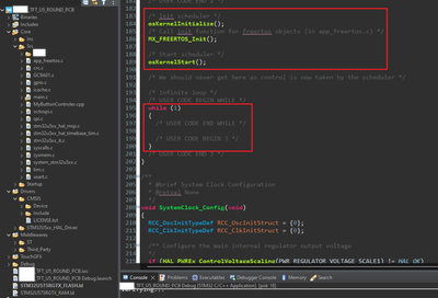

Hello all, I explain you my problem the best I can.
I have a project with the MCU STM32U575RGT6 The project has TouchGFX and FreeRTOS. After the initializations of the peripherals, I have the next calls, so the while(1) in main.c is not executed. As you can see in the next image.
So for the moment the only main loop I have detected in the application is the timer interruption.

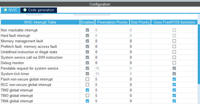

In CubeMX I have 3 timers defined: TIM17, which is been assigned to the system as the timebase source:

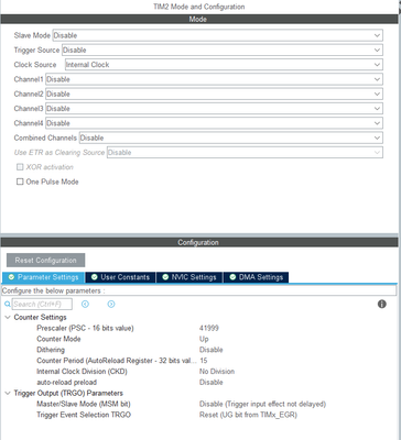

And timers 2 and 4 with the same exact parameters in CubeMX: (timer3 is related to an encoder....)
I initialize the corresponding interruptions.

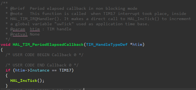

The problem is that in the interruption HAL_TIM_PeriodElapsedCallback I never get the call of the timer 4 instance.

Can you check please Timer4 registers (TIM4_CR1,TIM4_ARR,TIM4_PSC,TIM4_CNT),are they getting initialized and working like they should be?
Additionally, monitor the related pin to determine whether the timer generates a signal if possible.

In you main(), before anything else, try to call __set_BASEPRI(0)

How can you have HAL_IncTick() called from TIM4 IRQ when you assigned TIM17 as the HAL tick base timer ?
And your TIM4 is RTOS aware. Does not make sense.
