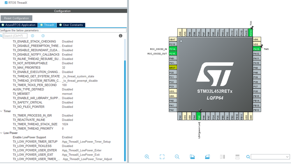

ThreadX with stop mode 1 works fine after power reset, but fail on run and debug.
dhs
Senior
I have completed the code and uploaded it to the following GitHub repository: https://github.com/gamarrita/Nucleo-L452_Azure_RTOS/tree/master/01_stop_mode_1
In my code, I am using the RTC and its wakeup capability to control sleep time. I am only using one thread, which sleeps for 5 seconds and then wakes up to sleep again.
The code works fine if I turn the power off and on again, but the CPU keeps entering and exiting a very high frequency if I just press the run or debug button.
Why stop mode works fine in one situation and fails in others?
And more important, how I can figure out, debug technique, to find out what is making CPU wakeup?

In may application has one thread which performs the following:
Turn led on -> tx_thread_sleep(20) -> Turn led off -> tx_thread_sleep(100)
  • LPTIM 1 is free running, LSE 32768, I am using it to measure time elapsed during sleep.
  • RTC will wakeup CPU in tx_low_power_next_expiration ticks
I added the debug message "x_low_power_next_expiration"
I was expecting to receive the following sequence of messages:
20 ... delay of 20 ms
200 ... delay of 200 ms
and repeat for ever
But I got
19 ... delay almost 20ms
0 ... almost no delay
(a total of 14 zeros with almost no delay)
199 ... delay almost 200ms
I understand where the difference of 1 comes from, but I don't understand why the zeros that are between these values?
The CPU is actually going into sleep mode for 20 and 100 ticks in each case.
