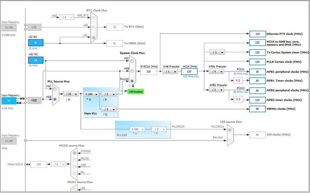

robert-hartung
Posted on August 18, 2015 at 19:39
Hi Provat,
looks like there was only one receive buffer that caused the problems :( When using a separate receive buffer for each OUT EP, it works really well. Thanks for your help. I generate the clock directly from CubeMX, and don't have problems with it!
See my attached image!
Regards,
Robert
