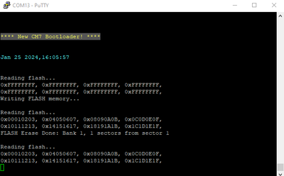

Hi there!
Experimenting FLASH reading/writing I done a fanny test that is giving an unexpected (to me) result.
Basically:
1) I defined 2 32 bytes buffers (aRbuff for read, and aWbuff for write)
u32t aWbuff[8U] = {
0x00010203, 0x04050607, 0x08090A0B, 0x0C0D0E0F,
0x10111213, 0x14151617, 0x18191A1B, 0x1C1D1E1F
volatile u32t aRbuff[8U] = {0};
2) I implemented my read, write and erase function and i integrated them into the main infinite loop
if(bIsErase == TRUE)
EraseFLASHsectors(uiADRtest, uiSect2Erase);
bIsErase = FALSE;
if(bIsWrite == TRUE)
printf("Writing FLASH memory...\r\n");
WriteFLASHdata(uiADRtest, aWbuff, 32U);
bIsWrite = FALSE;
if(bIsRead == TRUE)
printf("\r\n");
printf("Reading flash...\r\n");
ReadFLASHdata(uiADRtest, aRbuff, 8U);
printf("0x%08X, 0x%08X, 0x%08X, 0x%08X,\r\n", aRbuff[0], aRbuff[1], aRbuff[2], aRbuff[3]);
printf("0x%08X, 0x%08X, 0x%08X, 0x%08X,\r\n", aRbuff[4], aRbuff[5], aRbuff[6], aRbuff[7]);
bIsRead = FALSE;
Writing a FLASH word and reading it back works fine, but if I perform a sector erase and then I read newly the FLASH location I get the pattern I write previously... It seems the erase hasn't done!
But if i reset the MCU and connect again, reading the location gives al 0xFFFFFFFF, so erase has been performed.
Since Im working on the M7 core of a stmH755ZI, I'm in doubt that is a problem of cache coherence, and I tryed to address it in software without luck.
Since sutch topic is just a little cryptic to me, anyone has an idea?

Just as a test : disable (or not enable) caches , at least D-cache. Then try again.
‎2024-01-25 9:47 AM
Why wouldn't it be the cache? Either the architected one or the ST ART unit if present?
Your code doesn't show you doing anything to address that.
Should use the "DCache Invalidate by Address" after the FLASH write has completed.

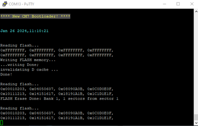

Hi everyone!
@AScha.3 :I done the test you suggested. Disabling (only) the data cache fix the problem, while disabling the instruction cache doesn't affect the reading behaviour.
@Tesla DeLorean : Actually i tried the cache management fix in another software branch (I posted only the original version giving the issue). I'm not using the ART.
@TDK : FLASH operation is validated through readings after MCU reset and through the test suggested by @AScha.3 .
Anyway, I tried several tests invalidating and cleaning the D cache without success. I always "pointed" to the reading buffer aRbuf.
This is because is not clear to me (in a nutshell)
1) What means clean or invalidate the cache
2) When clean or invalidate
3) On what operate...
Edit:
I done the tests that @Tesla DeLorean suggested (i invalidate the cache on aRbuf after FLASH writes)
SCB_InvalidateDCache_by_Addr((void*)aRbuff, 32);
bIsErase = FALSE;
printf("...writing Done;\r\ninvalidating D cache ...\r\n");
printf("Done!\r\n");
bIsWrite = FALSE;
if(bIsRead == TRUE)
printf("\r\n");
bIsRead = FALSE;
but the behaviour doesn't change.
No way! I should understand how to manage the cache!
‎2024-01-26 1:58 AM - edited ‎2024-01-26 2:08 AM
> 1 > " invalidate the cache" = kick out some cache lines ( = delete this copy of memory in the cache )
> 2 > IF D-cache is active, you have to "tell" the cpu/cache controller , if someone else than the cpu (maybe you or a dma ) modified the memory, that is possibly copied and still hold in the cache; so cache/cpu still have some data, thats no more the same, as now in the "real" memory and you have to delete now the "old" copy in the cache.
> 3 > Always clean the cache after anybody else than the cpu itself modified the memory content.
If using the cache management, you have 3 possible ways to do:
1. switch off D-cache (my "test" , to prove : here is the problem.
2. use the MPU to define some memory area as "not to use by the cache"
3. use the cache maintenance : to clean or flush the cache ; little problem here: the cache has 32 byte lines,
so you have to clean always to next 32 byte aligned memory address:
example for 1024 B espinbuf ->
SCB_InvalidateDCache_by_Addr((uint32_t*)(((uint32_t)&ESPinbuf[0] & ~(uint32_t)0x1F)), 1024);
