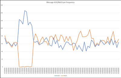

The issue we are encountering at the moment is that the device, when it sends data in  a certain range of bands it is mostly successful and when it sends outside of that list of bands it is about 50% successful

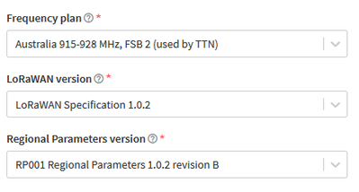

The configuration on The Things Industries that we are using is this:
Another point that might be interesting is that the device is sending a large amount of messages, so it could be that it is reaching a dutycycle restriction of some sort on the "good" channels and starts using the bad ones.

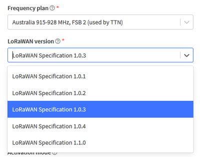

And on TTI I see these options (with blue is the one I assume I should be using, but I am asking anyway):

I realize that there is a contradiction between my original question where I am specifying that I am using the 1.0.2 specification.
At the moment the devices are indeed using that spec, but based on the finding in the code we should be using v1.0.3, correct?
In the scenario where 1.0.2 is used though is it normal that the device, after some time that uses the proper 8 channels starts using the other channels that are not being listened to by the gateway?
