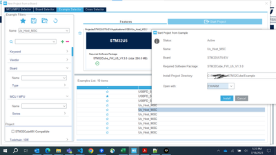

I am using STM32U575i-EV evolution board and trying to run the Ux_Host_MSC example code.
I generated the code using STM32 Cube Mx using example selector option, I generated the code for IAR.
As per the below readme file.
/STM32Cube/Example/Ux_Host_MSC/readme.html
I have configured or connected below jumpers.
JP25 : UCPD_5V Jumper
JP6 (UCPD_SRC) : Please on this jumper UCPD_SNK02 is mentioned on board.
JP14 and JP15 : both are connected to 1-2.
after flashing the code I am hitting the hard fault, could you please let me know which are the settings I might need to do if I generate the code using cubemx. currently I have not done any modification through cubemx.

Hi @RRajb.2 ,
Could you please try the example STM32CubeU5/Projects/STM32U575I-EV/Applications/USBX
/Ux_Host_MSC as is in the STM32CubeU5 package without importing it with STM32CubeMX?
Do you face the same issue?
-Amel
‎2023-08-07 10:20 AM
I am still facing the same issue, not able to identify which function or peripheral causing the hard fault.
