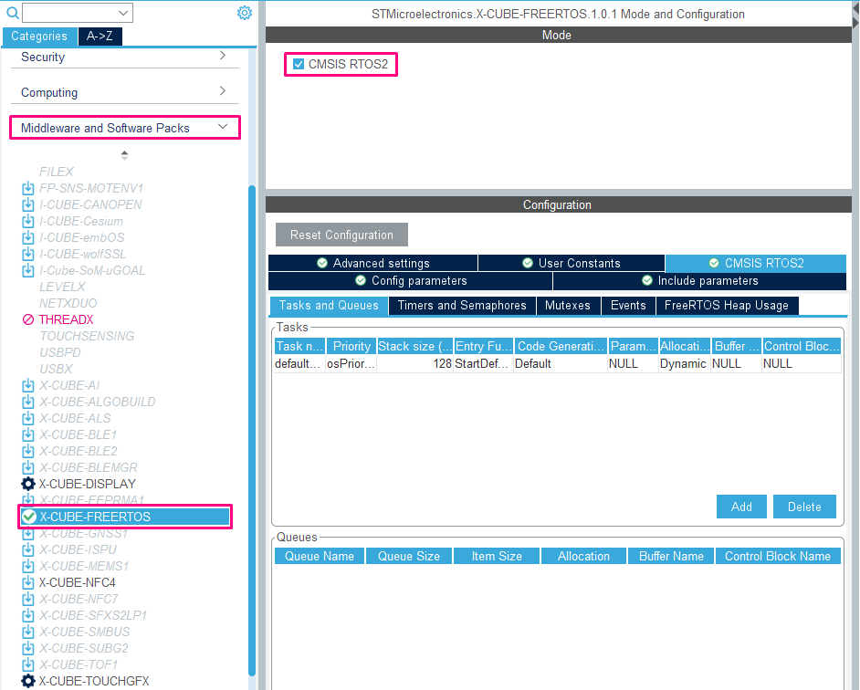

In this article, we cover the needed steps to use the FreeRTOS™ in tickless mode, specifically entering in STOP2 low-power mode with the STM32U5. In this example, we use the X-CUBE-FREERTOS™ pack with the LPUART and EXTI as the wake up sources.

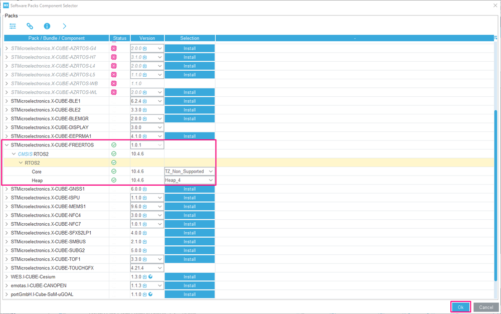

All the implementation was done over STM32CubeIDE 1.12.1 with STM32CubeMX 6.8.1, STM32CubeU5 1.2.0, and X-CUBE-FREERTOS 1.0.1. The NUCLEO-U575ZI-Q with STM32U575ZIT6Q MCU hardware was used but the steps can be easily tailored to any other ST microcontroller, with minor changes.

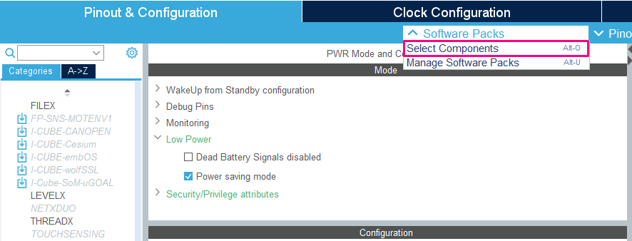

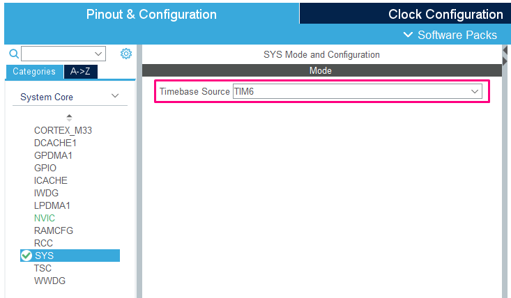

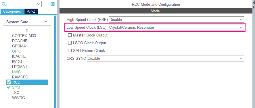

After its creation and naming, open the SYS tab. Under System Core, selecta timer as Timebase Source, TIM6 was arbitrarily selected. This step is needed since the SysTick timer is used by FreeRTOS™.

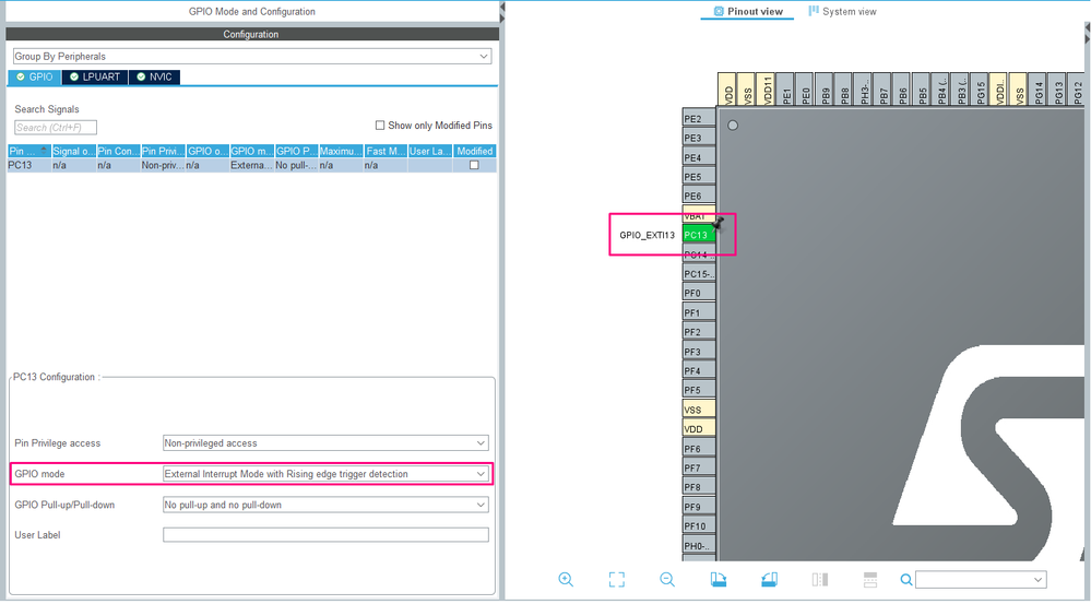

While in the System Core, locate the GPIO tab and set the PC13 as EXTI with External Interrupt Mode with Rising edge trigger detection. There is a push-button (active high) connected into this pin in NUCLEO-U575ZI-Q with a pull-down and a hardware debounce filter.

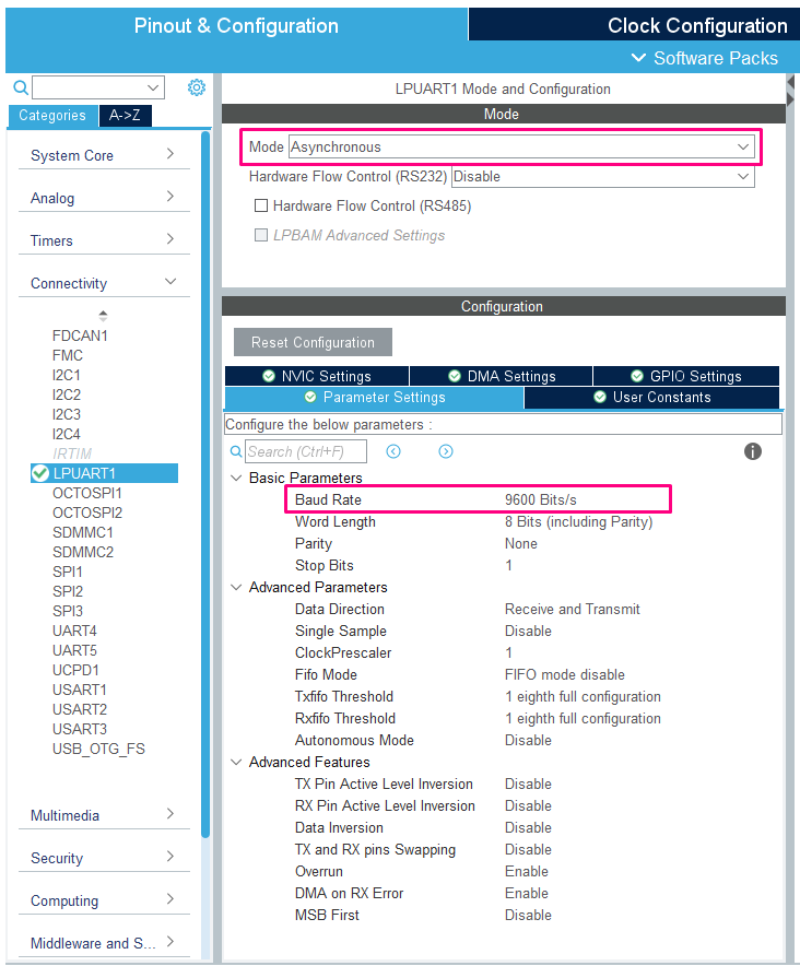

Under Connectivity tab, enable the LPUART1 as Asynchronous mode and apply your settings. In this tutorial, we use the standard UART settings (8/N/1), but with the 9600 bits/s for the baud rate.

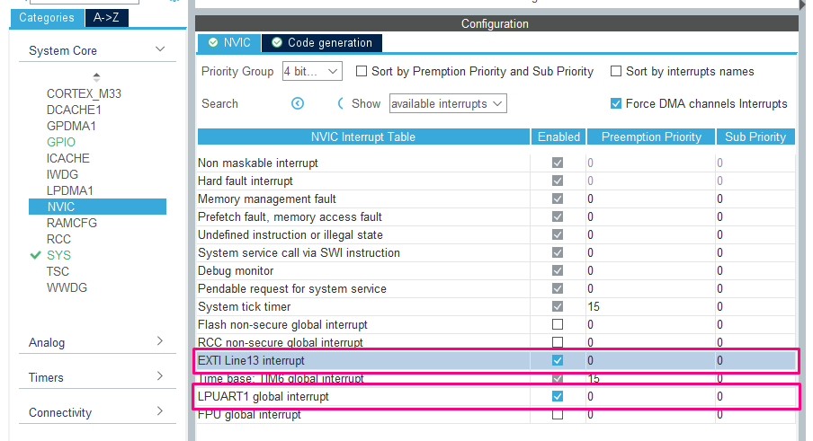

Back to the System Core tab, open the NVIC and enable both EXTI Line 13 and LPUART global interrupts.

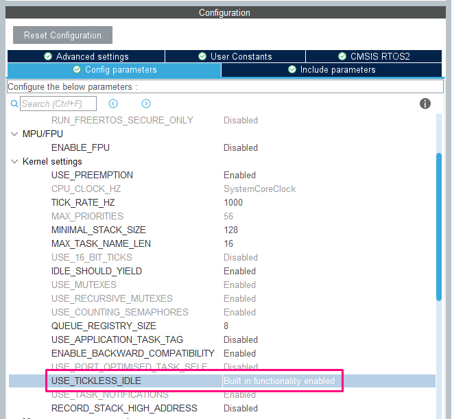

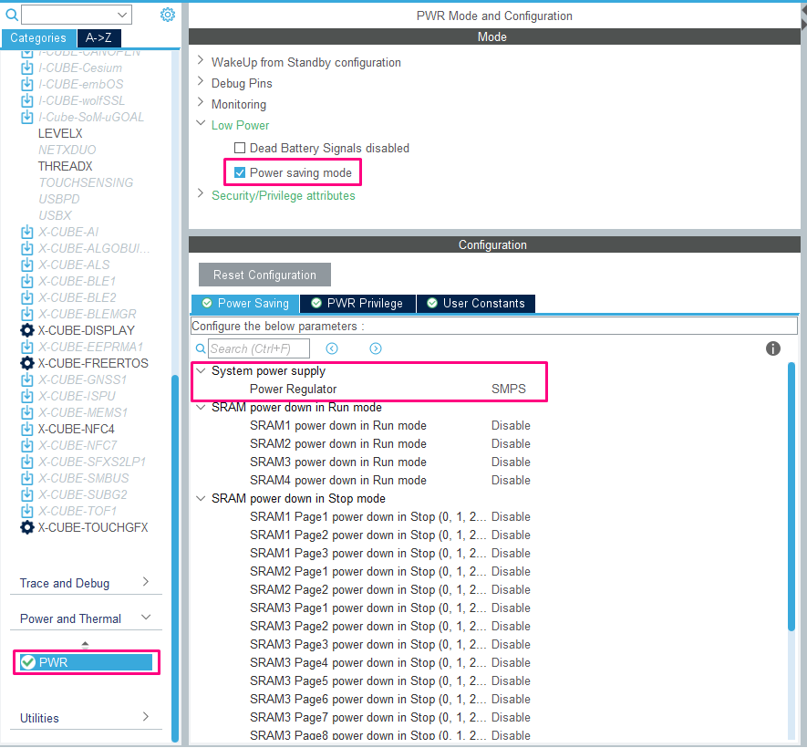

Change the Power Regulator to SMPS under PWR -> Power saving mode to achieve better current consumption values in low-power.

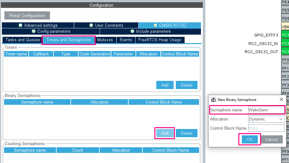

Once opened the project, open the Core/Src/app_freertos.c file. All the code implementations are done in this file. The first code is to include the stdio to use the printf function to log through the LPUART.

/* USER CODE BEGIN RTOS_SEMAPHORES */
/* add semaphores, ... */
osSemaphoreAcquire(WakeSemHandle, osWaitForever);

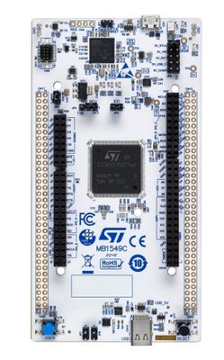

NOTE2: The LPUART1 is not the default connection to the ST-LINK VCOM embedded in NUCLEO-U575ZI-Q. You should connect this manually to a computer or change the solder bridges as illustrated in this image, extracted from the board’s user manual:

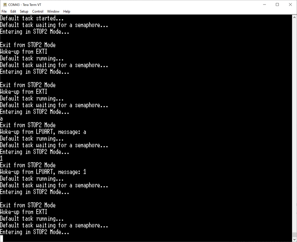

When the application starts, the DefaultTask is started and runs until the osSemaphoreGet instruction. After that, the Idle task is started and the PreSleepProcessing function is called and the MCU can enter in Low-Power Tickless mode.As set in the project, there are 2 available wake-up interrupt sources. The LPUART1 that waits for a character to be received and the EXTI that waits for the button to be pressed. Whenever an interruption happens, the PostSleepProcessing function is called, where we have the code to prepare the MCU after waking up from STOP2 mode.
The interrupt calls the callback function (according to the wake up source used) which releases a semaphore, letting the DefaultTask back to run mode until the osSemaphoreGet instruction is detected again.
The expected application behavior is illustrated in the image below, showing the TeraTerm view and messages output:

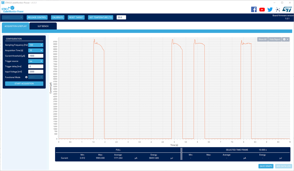

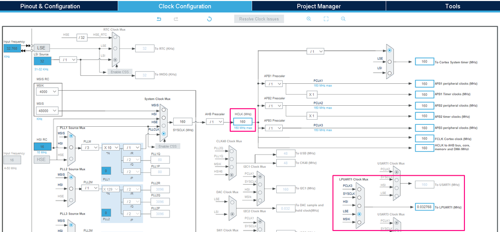

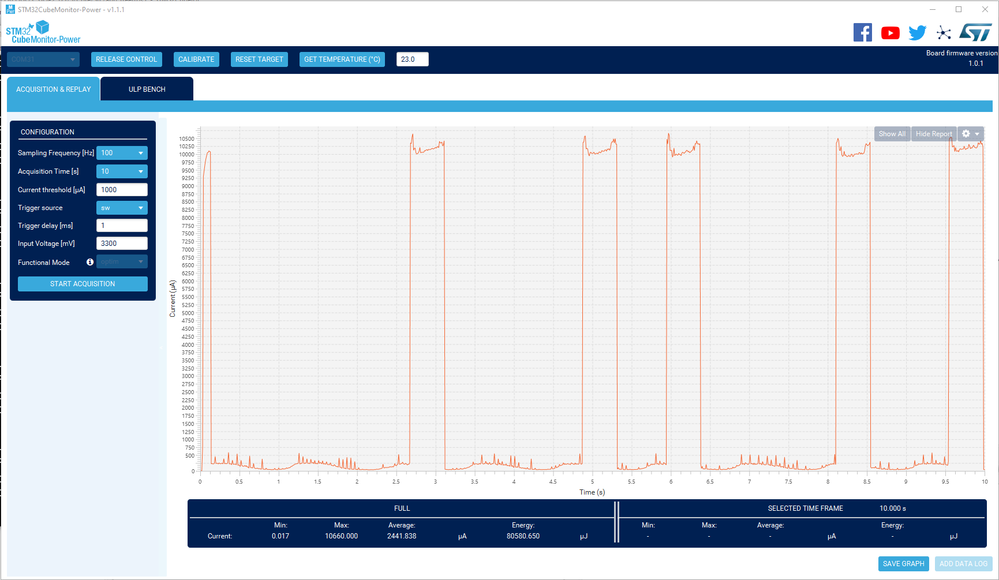

To offer a quick comparison between the consumption of LSE and HSI as clock sources for the LPUART, the following graph displays the application consumption while utilizing the HSI.
