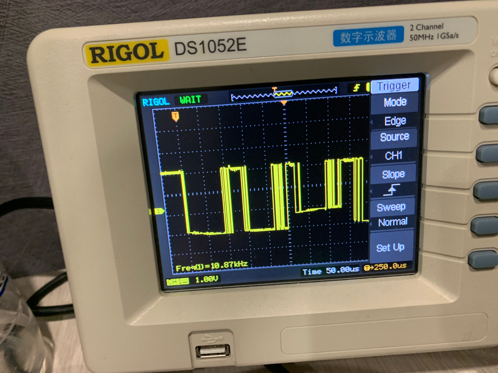

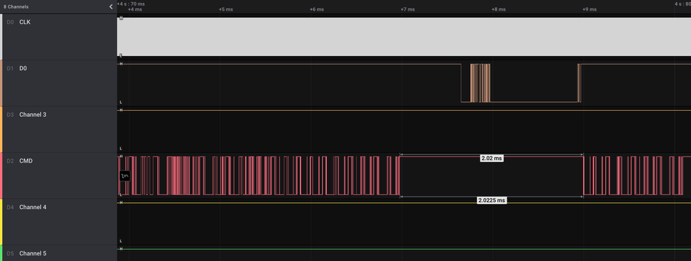

Debug mode shows SD CRC error - HAL_SD_ERROR_DATA_CRC_FAIL
Logic Analyzer shows some communication - card answer:
0693W00000D2cwEQAR.pngInitial clock 400 kHz, some request and replay.
SLesh.1
Oscilloscope says - you should soldering better... Problem was in soldering.
Some bytes a going to grey level. After repairing - SD card inited successfully.

What's the circuit look like? Pull-ups? Series resistors? 1-bit or 4-bit?
Some specific cards, or all?

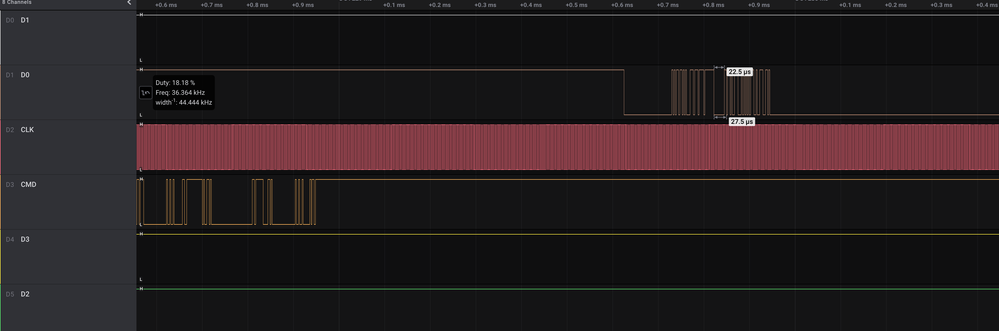

SLesh.1
Circuit looks like - pull up to logic 3.3V 110k, RC filter 33pF (to GND) 22R (serial). Bus - 1-bit.
When card is removed - no data on D0. When installed - the pic below. Timings looks nice - 1 bit strict 2.5 us.
0693W00000DpeFjQAJ.pngSD card - some one from nearest store - Mirex micro sd hc 8 GB. iMAC see it.
SLesh.1
