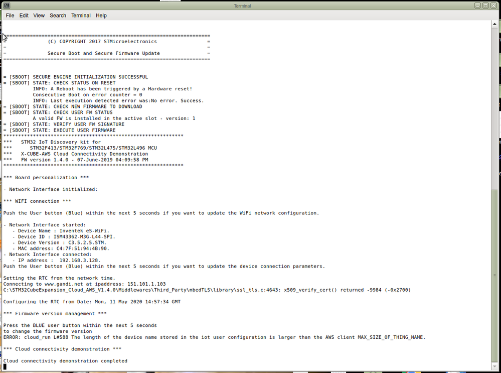

STM32L475 IoT Node has a firmware update with the STM32CubeExpansion_Cloud_AWS_V1.4.0 download. Firmware loads fine and the connection to a terminal for configuration takes place and shows the update version. The update will allow entry of the SSID and security mode but then 'Enter Password: ' prompt appears but does not allow the password entry but proceeds directly to the connection attempt, which fails without the password.
Is there an update or fix or a location in the code where I can fix this?

Still can't get this thing to connect and display sensor values. Tried many changes to get rid of this X.509 error. No luck.
Any suggestions? Is there an issue with the updated firmware v1.4 and the security config? The recommended connection config to the ST-AWS console just won't work for me.
Guillaume K
Hello
The x509 error you are seeing when retrieving time and date is not important. it's just to authenticate the time and date server.
What is important is the error with the name of the cloud device that is larger than the max size. It means the configuration area for AWS connection details is corrupted. it is not possible to connect to AWS cloud.
Did you try to press the board's user button to enter the configuration data when prompted ? (the blue button on B-L475E-IOT01).
To clean the configuration data you can try to erase the full Flash area (you can do this with STM32CubeProgrammer). Then you have to re-flash the firmware and it should ask you for WiFi details.
Or you can try to erase only the area in Flash memory where the configuration is stored. On X-Cube-AWS 1.4.0 for B-L475E-IOT01 it should be at address 0x080F2000 size 12 Kbytes (0x3000). (use STM32CubeProgrammer or ST-Link Utility).
Did the configuration data get corrupted after using the firmware update feature ? What was the previous version of the firmware ?

Thanks for the reply.
No problems entering the configuration using a terminal other than some issues entering the correct AWS security info. Still working on that.
I have reflashed with the latest firmware v1.4.0 using CubeProgrammer with no issues, complete with mem erase. I don't remember what version firmware
was installed from the factory.
I also read somewhere about a tls_ssl version conflict that may be preventing my connection.
Here is the latest connection attempt:
- Network Interface started:
  - Device Name : Inventek eS-WiFi.
  - Device ID : ISM43362-M3G-L44-SPI.
  - Device Version : C3.5.2.5.STM.
  - MAC address: C4:7F:51:94:4B:90.
- Network Interface connected:
  - IP address : 192.168.3.128.
Push the User button (Blue) within the next 5 seconds if you want to update the device connection parameters.
Setting the RTC from the network time.
Connecting to www.gandi.net at ipaddress: 151.101.1.103
C:\STM32CubeExpansion_Cloud_AWS_V1.4.0\Middlewares\Third_Party\mbedTLS\library\ssl_tls.c:4643: x509_verify_cert() returned -9984 (-0x2700)
Configuring the RTC from Date: Wed, 20 May 2020 19:05:21 GMT
*** Firmware version management ***
Press the BLUE user button within the next 5 seconds
to change the firmware version
AWS IoT SDK Version 3.0.1-
MQTT connection in progress:  Attempt 1/3 ...
Connected to a1mz2fy3wgyt70-ats.iot.us-west-1.amazonaws.com:8883
C:\STM32CubeExpansion_Cloud_AWS_V1.4.0\Middlewares\Third_Party\mbedTLS\library\ssl_tls.c:3831: mbedtls_ssl_handle_message_type() returned -30848 (-0x7880)
C:\STM32CubeExpansion_Cloud_AWS_V1.4.0\Middlewares\Third_Party\mbedTLS\library\ssl_tls.c:7005: mbedtls_ssl_read_record() returned -30848 (-0x7880)
ERROR: C:\STM32CubeExpansion_Cloud_AWS_V1.4.0\Middlewares\ST\STM32_Connect_Library\services\net_mbedtls.c:366 failed
 ! mbedtls_ssl_read returned -0x7880
ERROR: iot_tls_read L#208 net_recv failed - -109
ERROR: cloud_run L#682 Error subscribing JOB_GET_PENDING_TOPIC: -1
*** Cloud connectivity demonstration ***
Cloud connectivity demonstration completed
