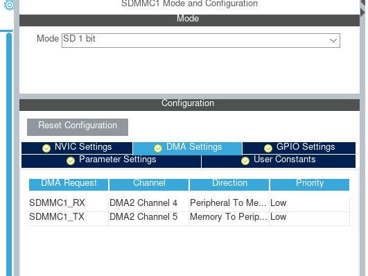

I'm using custom board with stm32l462re with sd card.
Without freertos and dma i'm able to write/read to sd card (32MHz on sdmmc clock, 1 bit mode, 10 clock divide factor). As project grows I decided to use freertos.
But now f_open send hard fault (disk_ioctl in Middlewares/Third_Party/FatFs/src/diskio.c)
What have I tried:
setting sdmmc in 4bit mode
different clock divide factors
physically removing sd card(same error)

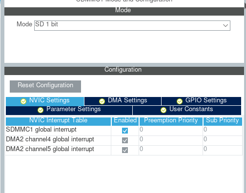

Even more debug: SD_read from sd_diskio.c. Where status = osMessageQueueGet(SDQueueID, (void *)&event, NULL, SD_TIMEOUT); is called which returns osErrorTimeout.
SYako
SYakoAuthor
November 23, 2020
Even more debug: right now 100% sure that BSP_SD_ReadCpltCallback is called and message is sended, but freertos is stalled in vPortValidateInterruptPriority, inside configASSERT( ucCurrentPriority >= ucMaxSysCallPriority );
SYako
SYakoAuthor
November 23, 2020
I was able to fix previous error by setting DMA priority to 8. By changing DMA to single SDMMC (instead of SDMMC_TX and SDMMC_RX) I'm able to open file, but I cant write to file, BSP_SD_WriteCpltCallback never occurs
kgai
December 1, 2020
there is a bug during this situation. you have to change the DMA peripheral dynamicly to RX OR TX. this bug has not been solved by st so far.​
