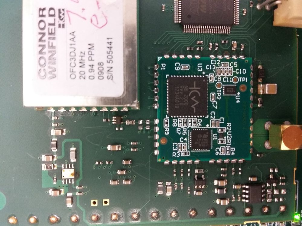

The processor is perhaps overkill in the application, but the die geometry of the newer STM32 is better, allowing for smaller packaging I can manage in manufacturing, plus the CM4 allows for a full JTAG and SWV debug channel, and 32-bit TIMs. My production guys don't like the wafer scale pitches, and the pin escape blows up the PCB layer/complexity/cost.
