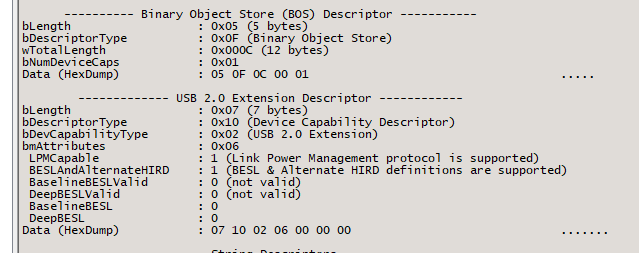

I have USB compocite device(USB HID+AudioInOut+CDC) on STM32L476 and I enabled LPM but my device do not receive Suspend(Device connected but no any data exchange)

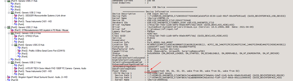

And one more point,my Windows10 has some device (I do not know who is it, it is part of my monitor) and seems this device in suspend mode and has no any BOS descriptor

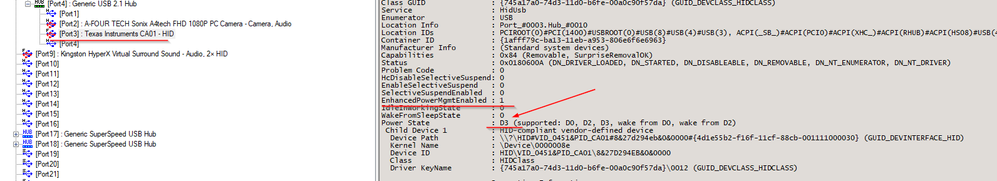

0693W00000FCfFpQAL.pngBut example has the followinf state:
0693W00000FCfEsQAL.pngMy BOS descriptor:
0693W00000FCfO3QAL.pngMy questions:
 - How OS(Windows or Android)host decide that device can enter in suspend mode?
 - Can I send device to suspend manualy by some system API (like ControlIO)
 - Type of USB Device Class can affect on suspend mode? Is it allowed for Composide devices?
 - Is it possible keep USB connection and use STOP1 mode after suspend received?
