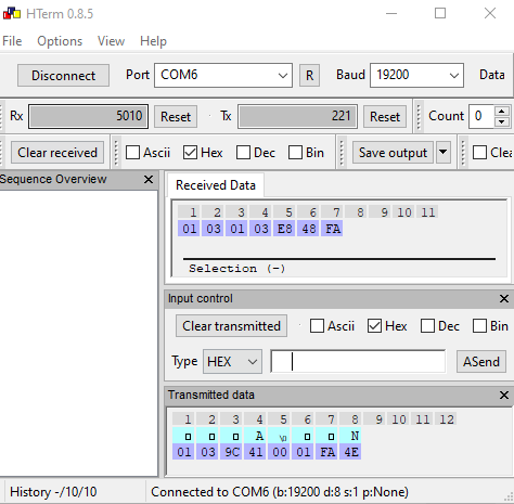

I just wrote a basic modbus slave on the STM32F401RE.
I am using a Baudrate of 19200 (tested also with 9600) and with the terminal "hterm" everything is working fine. As you can see in the picture below... I am getting the right frame with its correct data.

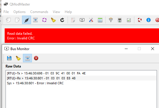

Usually I am using the program QModMaster which works fine with all of the modbus slave I've worked with in the past. Somehow using this program the last Byte of the crc checksum is not being transmitted. Does anyone have any Idea why?
You don't wait for the data to clock out on to the wire? TXE reflects a holding buffer, could perhaps be in the order of 20 baud clock cycles before the stop bit(s) leave via the shift-register.
Hello Tesla!
I am using the HAL_Transmit Function to write exactly the length I am writing to the function. My question is, why does the Modbus Master is receiving less bytes than Hterm. It looks o.k. on Hterm.
MAdam.7
That is the way I'm sending out the Data:
for (uint8_t c = 0; c < txBytesToSend; c++)
   USART2->DR = tx_Buffer[c];   // Load the Data
   while (!(USART2->SR & (1<<6)));
Between the read and the write operations there are no delays inside which could cause problems.
You should FRONT TEST for TXE, it indicates the DR buffer EMPTY, and can accept data. Don't blindly write to DR.
When all data has been sent you can BACK TEST for TC to indicate the UART has sent things
You should perhaps put a scope on the signal, and confirm that the last CRC bytes has left cleanly. Perhaps use a GPIO to trigger a Logic Analyzer so you can clearly capture the event for diagnostic purposed.
If you've confirmed it has left, then focus on the receiving end, as to why it doesn't receiver that byte. If there's anything going on with the signalling or delays causing that last byte to be missed, or some software side issue where it's not getting received or buffered, or recognized suitably.
