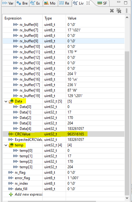

why does Modbus CRC calculation changes for each cycle, if called in while() loop!
‎2021-12-03 06:09 AM
The CRC_Accumulate() function has been called in while loop and the rx_data received as uint8_t and converted into uint32_t and then passed to CRC_accumulate() function in order to calculate the CRC value, but unfortunately the CRC value changes every cycle, what should I do to correct this behaviour?

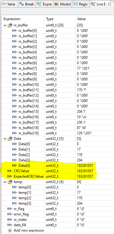

The uint32_t CRCValue changes every cycle, although the same rx_data is sent or Data[0-3] and temp[0-3] are same!
PFA Screenshot
What is wrong here? Please help!

‎2021-12-16 08:46 AM
I fixed the mistake in the code and now it works perfect!
/* USER CODE BEGIN PV */
uint8_t aintialText[] = "\r\nUSART Example\r\n";
uint8_t rx_buffer[RX_BUFFER_SIZE], rx_flag, rx_index, rx_data, error_flag, data_fill;
//CRC Calculation
uint32_t CRCValue = 0;
uint32_t ExpectedCRCValue = 0;
uint32_t temp[4] = {0x00000000, 0x00000011, 0x000000AA, 0x000000CC};
uint32_t Data[BUFFER_SIZE] = {0x00000000, 0x00000011, 0x000000AA, 0x000000CC, 0x0AEC5781};
int main(void)
/* USER CODE BEGIN 1 */
/* USER CODE END 1 */
HAL_Init();
/* USER CODE BEGIN Init */
/* USER CODE END Init */
SystemClock_Config();
/* USER CODE BEGIN SysInit */
/* USER CODE END SysInit */
MX_GPIO_Init();
MX_DMA_Init();
MX_USB_DEVICE_Init();
MX_FATFS_Init();
MX_SPI1_Init();
MX_RTC_Init();
MX_ADC_Init();
MX_I2C1_Init();
MX_TIM3_Init();
MX_TIM5_Init();
MX_TIM9_Init();
MX_USART1_UART_Init();
MX_TIM2_Init();
MX_CRC_Init();
/* USER CODE BEGIN 2 */
/* Initiate Continuous reception */
HAL_UART_Receive_IT(&huart1, &rx_data, sizeof(rx_data));
/* USER CODE END 2 */
/* Infinite loop */
/* USER CODE BEGIN WHILE */
while (1)
if (rx_flag==1){
Data[0] =rx_buffer[0]<<24|rx_buffer[1]<<16|rx_buffer[2]<<8|rx_buffer[3];
Data[1] =rx_buffer[4]<<24|rx_buffer[5]<<16|rx_buffer[6]<<8|rx_buffer[7];
Data[2] =rx_buffer[8]<<24|rx_buffer[9]<<16|rx_buffer[10]<<8|rx_buffer[11];
Data[3] =rx_buffer[12]<<24|rx_buffer[13]<<16|rx_buffer[14]<<8|rx_buffer[15];
Data[4] =rx_buffer[16]<<24|rx_buffer[17]<<16|rx_buffer[18]<<8|rx_buffer[19];
temp[0] = Data[0];
temp[1] = Data[1];
temp[2] = Data[2];
temp[3] = Data[3];
ExpectedCRCValue = Data[4]; // 0x0AEC5781
HAL_Delay(500);
CRCValue = HAL_CRC_Calculate(&hcrc, (uint32_t *)&temp, 4U);
if(CRCValue != ExpectedCRCValue)
error_flag=1;
rx_flag=0; // set the rx_flag as false
HAL_GPIO_TogglePin(GPIOB, GPIO_PIN_5);
HAL_Delay(500); //250 ms delay
/* USER CODE END WHILE */
/* USER CODE BEGIN 3 */
/* USER CODE END 3 */
static void MX_CRC_Init(void)
/* USER CODE BEGIN CRC_Init 0 */
/* USER CODE END CRC_Init 0 */
/* USER CODE BEGIN CRC_Init 1 */
/* USER CODE END CRC_Init 1 */
hcrc.Instance = CRC;
if (HAL_CRC_Init(&hcrc) != HAL_OK)
Error_Handler();
/* USER CODE BEGIN CRC_Init 2 */
/* USER CODE END CRC_Init 2 */
void HAL_UART_RxCpltCallback(UART_HandleTypeDef *huart)
if (huart->Instance==USART1)
//if the data is not being received, clear the buffer
if(rx_index ==0)
for (int i=0; i<20; i++)
rx_buffer[i]=0;
//if the character received is other than 'enter' ASCII13, save the data in buffer
if(rx_data!=13)
rx_buffer[rx_index++]=rx_data;
else
rx_index=0;
rx_flag=1; // turn the rx_flag 'ON'
HAL_UART_Transmit_IT(&huart1, rx_buffer, sizeof(rx_buffer)); // transmit the data via UART
HAL_UART_Receive_IT(&huart1, &rx_data, 1); // restart the interrupt reception mode & receive only 1 char at a time!
The mistake was:
CRCValue = HAL_CRC_Accumulate(&hcrc, (uint32_t *)&temp, sizeof(temp));
This was the reason, the calculated CRC value was incorrect before!
Now, I modified as:
CRCValue = HAL_CRC_Calculate(&hcrc, (uint32_t *)&temp, sizeof(&temp));
Now, I got the expected CRC value (see the screenshot)!
But the problem now is my Modbus slave device can only generate 16 bit CRC codes and my STM32L1 series can only validate/process 32 bit CRC code! I don't know if there is any possibility where I can use the same STM32L1 series MCU to validate transmission from Modbus device with CRC 16bit validation(or polynomial)! As far as I know in STM32L1, there is no possibility to configure CRC settings (I tried in CubeMX and also in Code, both doesn't let me modify any CRC settings)!
Please help if anybody has any suggestion!
Thank you!
Regards,
Thangaraj
