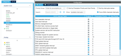

I'm using STM32H750VBT
When I'm trying to use DMA for ADC data collection I'm experiencing MCU crush. Currently I know that issue happens when DMA fill half of defined buffer.

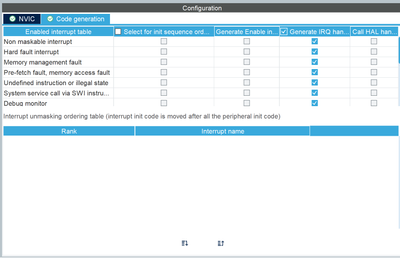

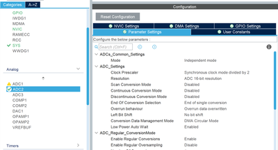

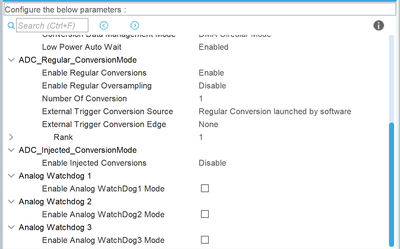

I'm using STM32CubeIDE and builded in CubeMX. To precize issue I used debug By SWD STLink. to be able run code step by step I desabled continuous conversion mode. Attaching my Cube MX  ADC settings:

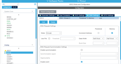

And DMA settings
After pre configured by CubeMX initiation I'm calling conversion by
HAL_ADC_Start_DMA(&hadc2, (uint32_t*)testDMA, 20);
And entering into while (1) loop where calling adc2 conversion
HAL_ADC_Start(&hadc2);
after every loop I checking testDMA[] buffer

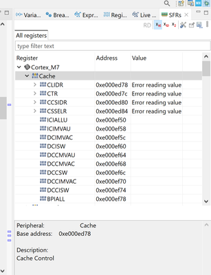

and DMA cycle by cycle fills testDMA as well up to [8], but on testDMA[9] debugger shows errors and don't able to cintinue code running (example on attached screen)
I tried to change in HAL_ADC_Start_DMA(&hadc2, (uint32_t*)testDMA, 20); from 20 to any another value and issue happens on half of the defined buffer.  array testDMA is big enough, in that case it's uint16_t testDMA [60];

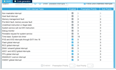

Probably isue occurs because MCU can't call/execute interrupt

After downgrade-ing from CubeIDE 1.14.0 to 1.8.0 and changing from firmware package H7 v1.11.2 to V1.11.0 everything works as should, so there is a bug in newer lib or MX pre-configurator.
