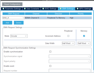

Hello @Patryk_Kucia
Could you please share your dma config?

and simply
  if (HAL_SAI_Receive_DMA(&hsai_BlockA4, (uint8_t*)PDM_Buffer, PDM_BUF_SIZE) != HAL_OK)
      printf("SAI RX start error!\r\n");
  else
      printf("SAI RX started OK\n");
