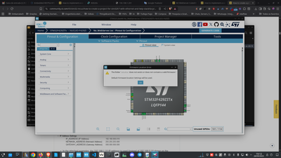

This error is happening when I load the project into CubeMX for the first time.carlosdelfino_0-1759097642723.png

Did you install your F4 firmware in a location other than the default one? Have you tried removing both the project and the firmware, then reinstalling them in the default location?

I've already tried removing and creating the project, but I always get this error. I'll try removing the firmware and reinstalling it. I'll also try removing everything and reinstalling everything. I use Linux and have never had similar problems. Strangely, the compilation works, but the code seems empty in terms of the example's purpose.
