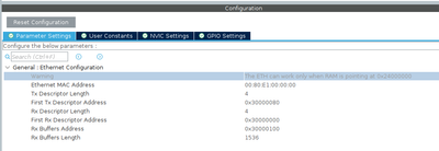

I have added below block in STM32H747XIHX_FLASH.ld
as i want to enable Ethernet in CM4, I've added below block in FLASH.ld file of CM4.
MEMORY
FLASH (rx) : ORIGIN = 0x08100000, LENGTH = 1024K
RAM (xrw) : ORIGIN = 0x10000000, LENGTH = 128K    /* ETH_CODE: split memory to data and ethernet buffers */
ETH_RAM (xrw) : ORIGIN = 0x10020000, LENGTH = 160K    /*added*/
.tcp_sec (NOLOAD) :
. = ABSOLUTE(0x30000000);
*(.RxDecripSection)
. = ABSOLUTE(0x300000100);
*(.TxDecripSection)
. = ABSOLUTE(0x300000200);
*(.NetXPoolSection)
} >ETH_RAM AT> FLASH
but getting below error.
"/opt/st/stm32cubeide_1.16.0/plugins/com.st.stm32cube.ide.mcu.externaltools.gnu-tools-for-stm32.12.3.rel1.linux64_1.0.200.202406132123/tools/bin/../lib/gcc/arm-none-eabi/12.3.1/../../../../arm-none-eabi/bin/ld: DISCO-ETH_0_CM4.elf section `.tcp_sec' will not fit in region `ETH_RAM'
/opt/st/stm32cubeide_1.16.0/plugins/com.st.stm32cube.ide.mcu.externaltools.gnu-tools-for-stm32.12.3.rel1.linux64_1.0.200.202406132123/tools/bin/../lib/gcc/arm-none-eabi/12.3.1/../../../../arm-none-eabi/bin/ld: section .tcp_sec VMA wraps around address space
/opt/st/stm32cubeide_1.16.0/plugins/com.st.stm32cube.ide.mcu.externaltools.gnu-tools-for-stm32.12.3.rel1.linux64_1.0.200.202406132123/tools/bin/../lib/gcc/arm-none-eabi/12.3.1/../../../../arm-none-eabi/bin/ld: region `ETH_RAM' overflowed by 12616184320 bytes
collect2: error: ld returned 1 exit status"
getting below warning in Ethernet configurations. and ram origin is "0x10000000".
So which is the correct address for RAM in CM4 ? please guide us on the same.
