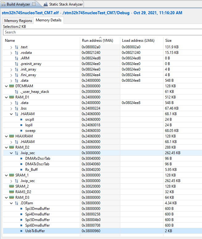

Stm32h745, freertos&LWIP is hogging SRAM1 memory.
Ihawk.1
LWIP is hogging memory where it didnt oughta be.
...\ld.exe: section .SRAM2 VMA [0000000030020000,0000000030031033] overlaps section .lwip_sec VMA [0000000030000000,00000000300419cf]
but in the .ld file is allocated thus
/* ethernet Modification start */
 .lwip_sec (NOLOAD) : {
  . = ABSOLUTE(0x30040000);
  *(.RxDecripSection)
  . = ABSOLUTE(0x30040060);
  *(.TxDecripSection)
  . = ABSOLUTE(0x30040200);
  *(.RxArraySection)
 } >RAM_D2
Why does LWIP behave this way please?, what might I be doing wrong here?
It all seems to work cm7 wise(though clearly the CM4 core memory SRAM1,SRAM2 that aliases here is not available) . I have put the uncached dma buffer that was in CM7 SRAM in a block of axiram, but this is a bodge.
Ihawk.1
 This seems to have fixed it, though I don't understand why it is necessary to create the additional memory sub region
 "RAM3_D2 (xrw) : ORIGIN = 0x30040000, LENGTH = 32K":
  *(.RxDecripSection)
  *(.TxDecripSection)
  *(.RxArraySection)
 } >RAM3_D2
