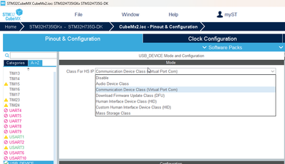

Is their any possibilty to use CDC and DFU due to the same USB Port, by switching it by software? And is their any example for it? I tried several things but couldn't find any solution. The configuration at CubeMX Just allows one Class for USB_DEVICE Mode.

Thanks for the example, but how can i migrate such a project to my hardware? I tried by creating and comparing and merging a new project for my hardware but without any success. Do you have any tip?
TedicoAuthor
Sep 21, 2023 1:09 PM UTC
I now was able to create a project including CDC_ACM and DFU and the initialization also looks well. The code is similar to the other example with CDC_ACM and HID.
Nevertheless i have problems to run it at the target device STM32H735. In the debug session that function call _tx_thread_schedule(); never returns.
Does anyone have any idea, what I'm doing wrong?
Attached I have the project.
Thanks in advance.
