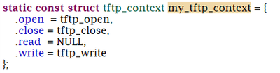

For TFTP server to work properly it is recommended to use the tftp_server source and header files in Middleware. Earlier I was referring to the GitHub code in which a different file is created for initializing TFTP server, which came with many problems like mentioned above. After creating new project and by using this autogenerated files by STM32CubeIDE, I accomplished creating a TFTP server on stm module and transfer a file.
Some points to consider when using this file:
- To initialize TFTP server we have to define the function pointers for handling file I/O operations. This structure is used by the TFTP server to manage file transfers, including opening, writing, and closing files.
- This functions are called from the recv function in the tftp_server.c file.
