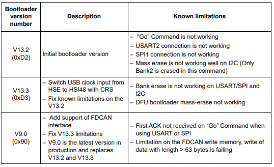

Hello @Dub Bartolec​ ,
Could you please let me know the bootloader versions on both devices (rev Y and rev V)?
You can get it @0x1FF1E7FE .
  • If it version is V13.2, there is already a known limitation ==> “Go�? Command is not working
  • If it is V9.0 , the following is known as a limitation: "First ACK not received on “Go�? Command when using USART or SPI". The impact of this later is that STM32CubeProgrammer will show a failure error message, but really you can jump to the application and run it.
Details about the known limitations on bootloader versions are provided on table Table 91of AN2606. STM32H74xxx/75xxx bootloader version:
-Amel
Hi Amel,
I am sorry to say but this table above is all wrong.
In fact GO command works in v13.2 (Rev Y chip) but it doesn't in v9.0 (Rev V chip) as per my report.
