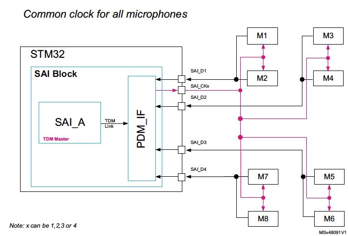

I'm looking at a number of ways to interface 8xPDM microphones and one of the ways is using an STM32H7 with it's SAI/PDM interface. According to the documentation (AN5027, 4.3.1), I should be able to select up to 8 microphones in the H7 SAI1_A block once I set the mode to "Pulse Density Modulation" (see image below).
When I create an STM32CubeMX project however (STM32H743ZI MCU), it only lets me select up to 6! I've tried others in the H7 family and get the same result.
Is this a bug in CubeMX or have I missed something? Are there any code examples of configuring the SAI peripheral in this way?

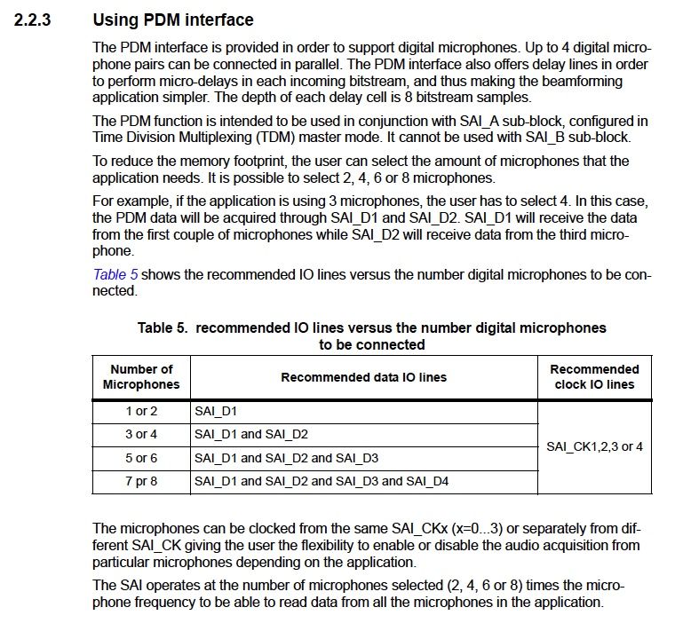

Thanks for the quick response Amel, I'll have a look at that. Could you let me know where in the datasheet you're referring to so I can read over it? I've been going by AN5027, which has:
Reading this suggested to me that it's all driven from a single SAI peripheral (especially because of the option of 1 clock for all 2x4 pairs).
Also looking at the generated code, if I select NumberofMicrophones to '5-6' then it generates 'SAI_PdmInitTypeDef.MicPairsNbr = 3' and the comment for that field is 'Specifies the number of microphone pairs used. This parameter must be a number between Min_Data = 1 and Max_Data = 4.'
Thanks again for looking into it.

One of the repeated weaknesses of the STM32 documentation is the link between the individual IP modules and their particular implementation in a given chip.
While SAI module supports up to 4 PDM data pins, in 'H743 (and kin) simply not all of them are brought out to external pins (through the GPIO AF matrix). Maybe in future 'H7 or other STM32 products they will be... If you look into the datasheet, you'll see that there are only SAI1_D1, SAI1_D2, SAI1_D3, and SAI4_D1, SAI4_D2, SAI4_D3. SAI2 and SAI3 have no PDM data pins brought out. So that's 3 data pins per SAI, 2 mics per data pin (stereo) and 2 SAIs, so you can connect altogether 3x2x2 =12 PDM mics to the 'H743 (unless you have a small-pin-count package where not all these are brought out), but only 6 per SAI.
